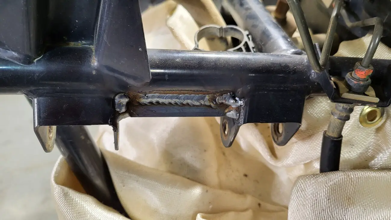

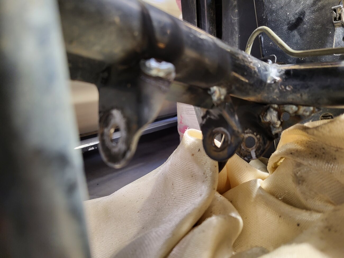

20231203 112446
I welded the backsides of the upper mounts and added a gusset to the upper rear so it can't twist again.
20231203 122200
I also added a plate between the front & rear just to tie it all together
