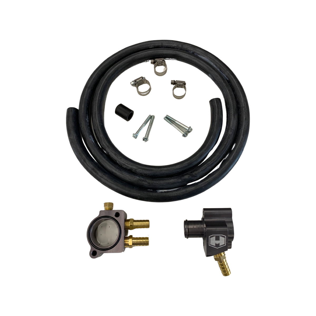

Has anyone installed one of these and how difficult was it? I just purchased this and the instructions that they send the pics are not very clear. I also bought the razorback temperature gauge to install with it. Any help would be greatly appreciated.

I'm skeptical, not sure what flaw they're think they've found but the T1K/P1K cooling system is quite simple and typical by automotive standards. Coolant is circulated in a closed loop (with a limited amount of bypass) until the thermostat opens, then coolant is routed to the radiator. This keeps the engine/oil at a steady temperature range.

I run it on my race car. I know several others who do as well and it definitely helps if you run hard for extened length of time. I'm no help with the hose routing though because I run a remote oil cooler and I'm only using 1 of the two billet engine adapters that came with the kit.

Put me in the skeptical camp as well.
All IC engines recirculate nearly all their cooling water…which is controlled by a tstat. The Tstat controls the engine operating temperature.
Want a cooler running motor…run a cooler tstat or drill it.
This kit sounds like it’s short circuiting the tstat which is not good either…
Hot oil temperatures … like what temp? That’s a bogeyman comment imo. Where’s the oil failures? Sludged up motors? Etc etc etc….
You want hot oil, it keeps the moisture buildup at bay etc, and minimizes wear. 200 to 225F is nothing for modern oils. Even short runs on 250f will plus won’t hurt a thing.
Ed Zachary.... running without or bypassing the Tstat is a good way to cook an engine, the Tstat also functions as a restrictor, to slow coolant flow so it has time to absorb the heat.

The Hess kit isn't made for you trail riders, it's made for racers. If you don't hold your car WFO for 15+ minutes while racing you will never see the benefit of the kit or even know why its needed. Be skeptical and don't buy it, it's not for you guys.
Please explain?
Us lowly trail riders are also Engineers, Designers, mechanics, etc,etc….and former racers!
You really think Hess has the design software and heat modeling capability of Honda?
I’m simply pointing out the years of available data at everyone’s eyeballs is contradictory to the very lean at best statements on the website, and their comments are blatantly ignorant of how the thermostat manages engine temperatures. Taking your backyard laser temperature gun around the block doesn’t tell you crap about the actual internal engine temperatures….it only gives a indicator of that very small spot that can vary due to casting design, air currents and density.
If Hess’s statements were actually true, and bad as they state ( without data I might add) don’t you think there would be engine failures a a noticeable level?
When’s the last time a race motor started and shut down repeatedly for several times a week often below operating temp, month etc and forced to run years on the same air filter, crappy oil etc? Never.
Holding the throttle open on a computer governed motor for 15 mins is nothing at all. Those are easy minutes.
Hell I know racers that used to dump their oil every single heat…
What I do know…racers will throw money at “race parts” like a drunk groom at an adult bar before wedding day….and in the eyes of the smart marketing teams for race parts companies….a race part can be anything with their name on it and a very basic claim.
Running a larger radiator, more efficient fan system etc is how you manage system cooling.

Some of the coolant bypasses the radiator in the maze of hoses that run around the engine. Run WFO for 10-15min while racing in Texas 100° heat and slowly but surely your temp creaps up and up. I've had this problem since building my car and apparently so did Hess (who I'm not a fan of at all) and they figured out how to solve it. I put the kit on my car and I no longer have that problem. I can run laps until I literally run out of fuel now and the temp never passes the half way mark. If you don't have a problem with this you will never need this to solve it and won't notice a difference at all.
