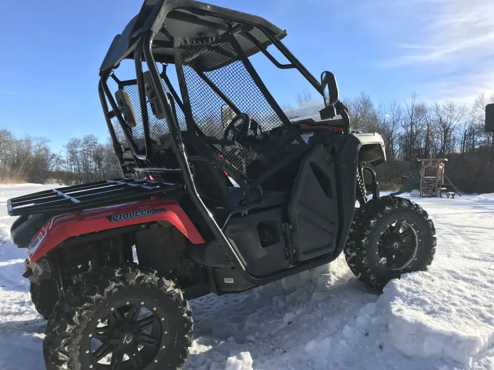

The trip home was uneventful but I do believe the trailer was airborne a few times:eek:
Unloaded and took it around the yard a few times and I’m very happy to finally have a P5:)

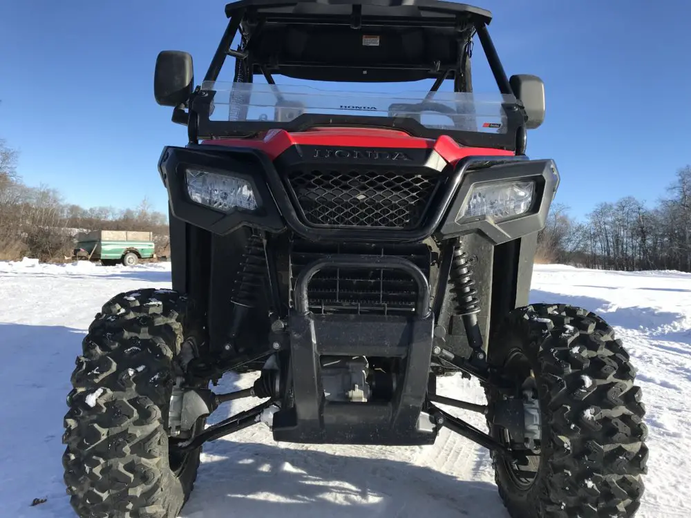

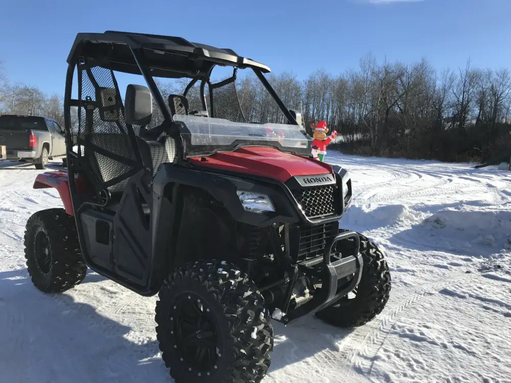

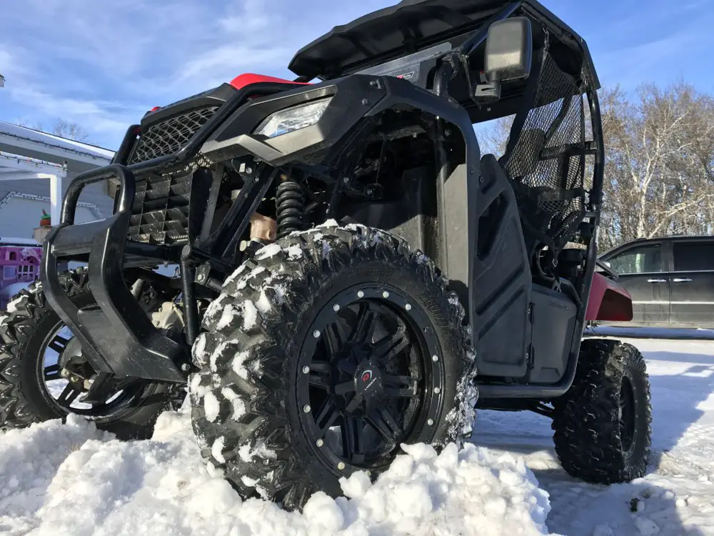

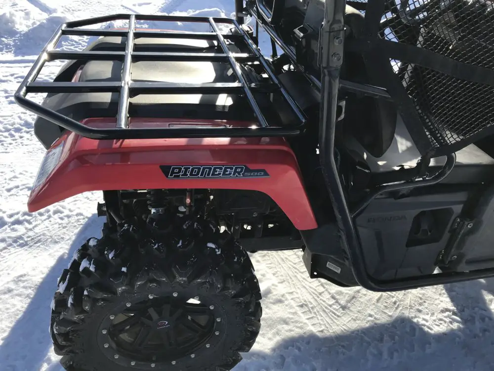

I will start a build thread when I think of a name, but here are a few pics for now:cool:

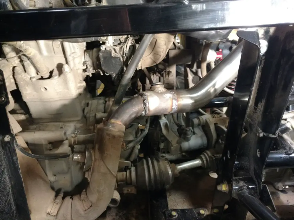

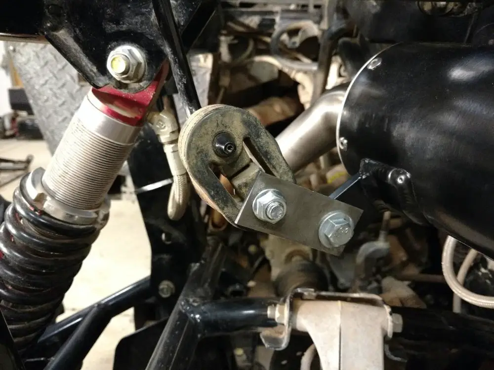

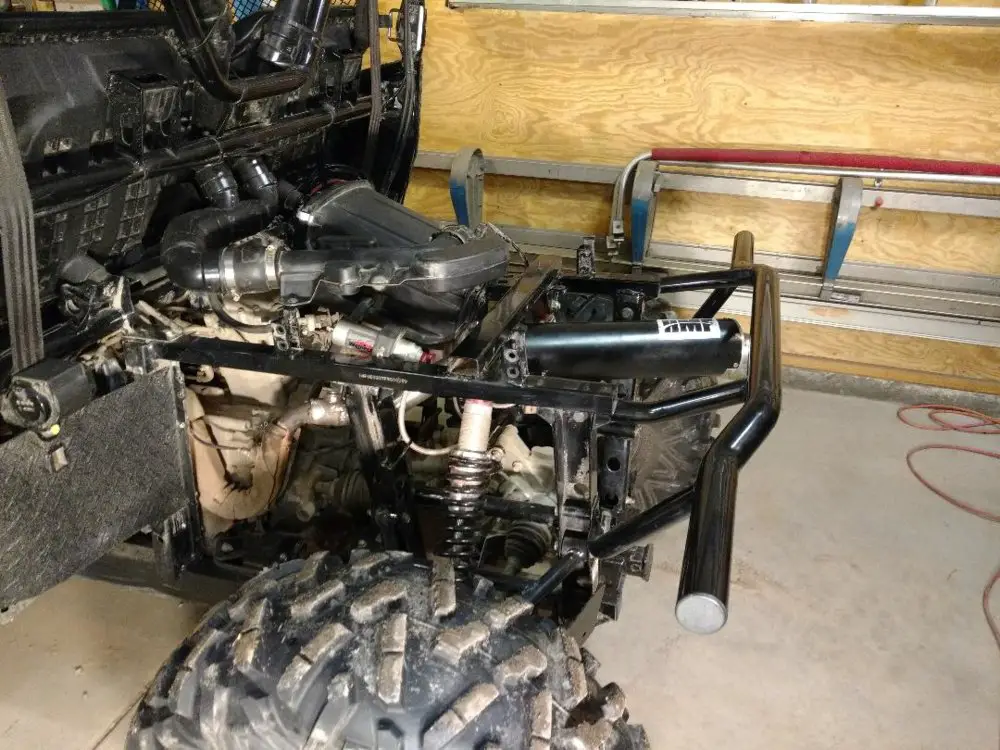

Wow, it's louder! Not just on the throttle either, noticed it as soon as I started it.

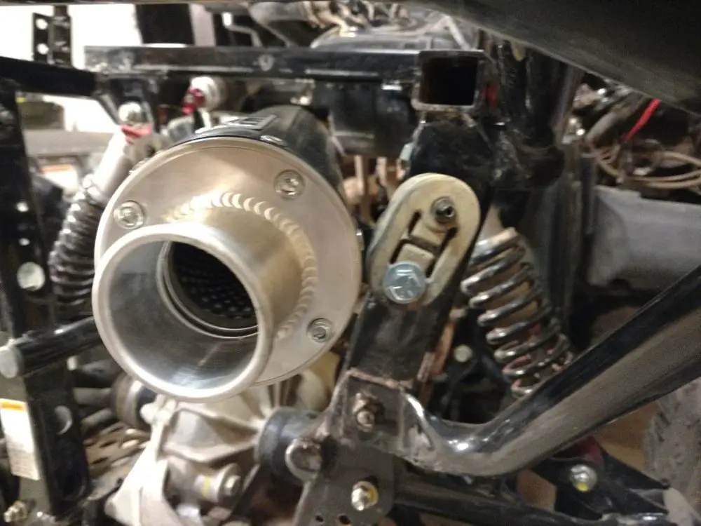

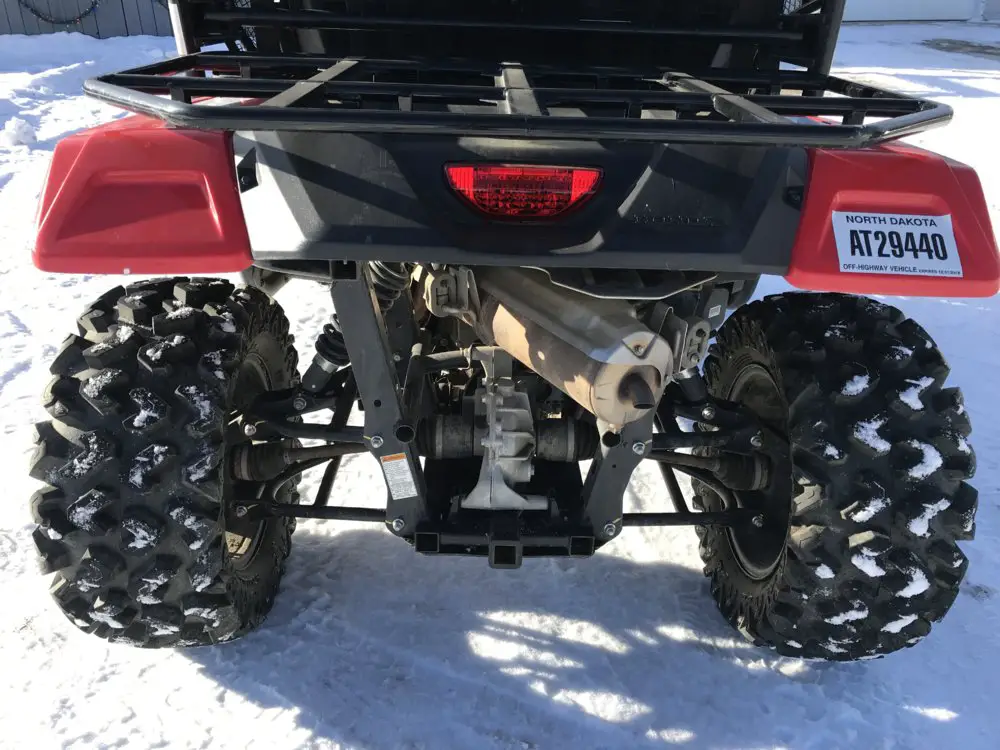

This is how my guy ended up doing it. One hanger lined up and the other needed a bracket. Pretty much what @Talen showed. Welded the (bungie was what he kept calling it) :D at the proper angle to the inside. He used hardware he had laying around just to bolt it up, I plan to go through it all with the proper lengths and nyloks and paint it up. Almost everything on it is going black, hardware, pipe, tail piece.
HMF Full HMF Weld
HMF Bracket HMF Rear Bought some heat tape now that the shields are gone, that sh**'s expensive!
View attachment 99218 View attachment 99219
View attachment 99220 View attachment 99221 Bought some heat tape now that the shields are gone, that sh**'s expensive!
Sound clip we needs to hear.
Looks awesome will be great to see results of combo.
