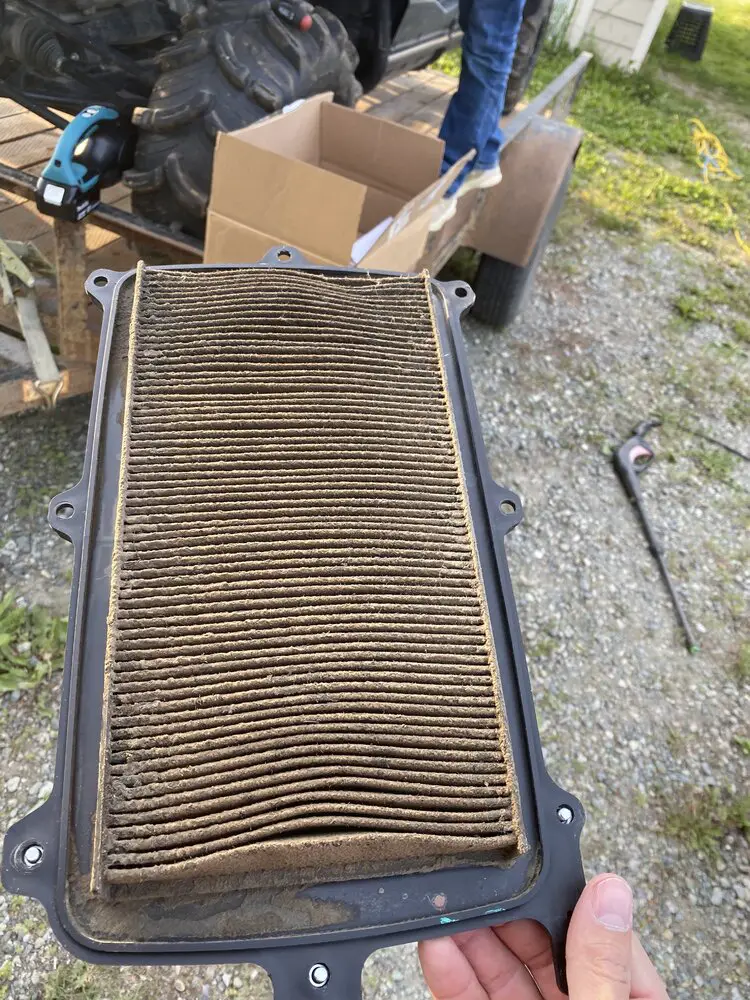

Just installed mine.
fit great.
AA43CD7A 119F 44F9 9A8E 4C8D01694613
replaced this.
