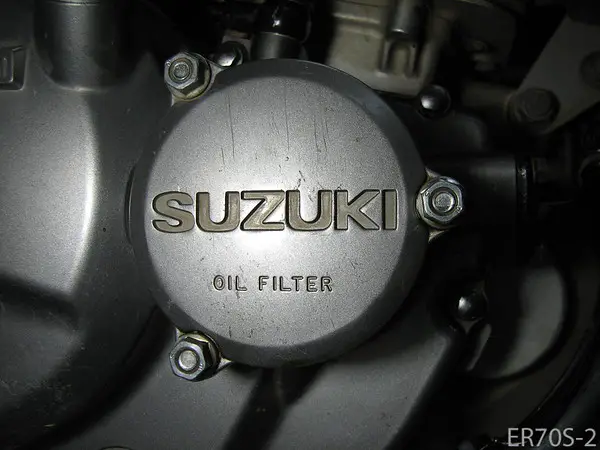

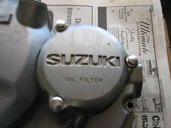

I understand the concern about this as well,,, I have been toying with putting studs in and leaving them installed and then tightening down with nylock nuts,,, this type of nut stays in place without putting a lot of torque on the studs. Any thoughts?
I think it's a good idea and I may do the same to my engine oil and DCT filter covers - I don't like screwing steel fasteners into aluminum threads over and over and over.
I replaced the bolts with studs on my motorcycle filter cover for that reason.
Were bolts -
403 M
now studs, steel on steel.
IMG 2365 M
F

I just worry about the rubber puckering and letting dirt past the filter. One would think they designed taking all things into account. I like your idea but it still leaves the same question how tight is too tight?
I considered that with studs the rubber would not be as likely to pucker,,, at least it would be easier to hold the filter in place while installing it. What I do is coat the contact area with grease (belray) and tighten down the screws about 20 inch pounds and then check them after every extended ride. The grease works to keep dirt from getting under the rubber, additionally I grease the sealing area around the entire cover. Never a leak and if there was one the dirt would collect to the grease and I could visually see where the problem area was.
Were bolts -
I hate having to do the same thing. If you ever do install studs, PLEASE post a write up!
