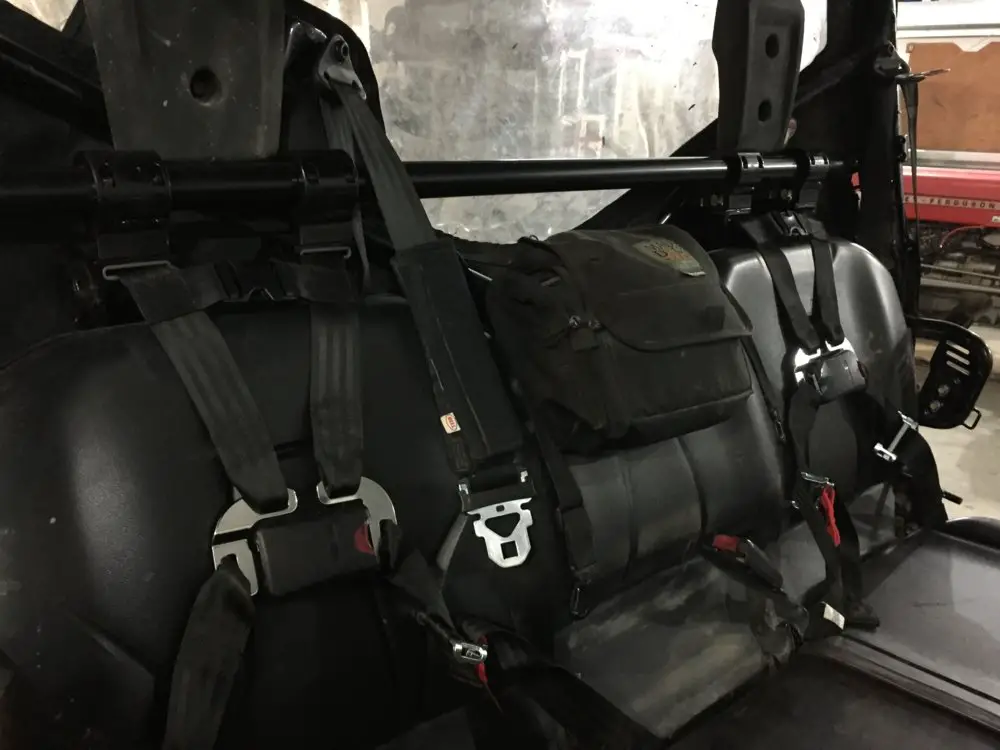

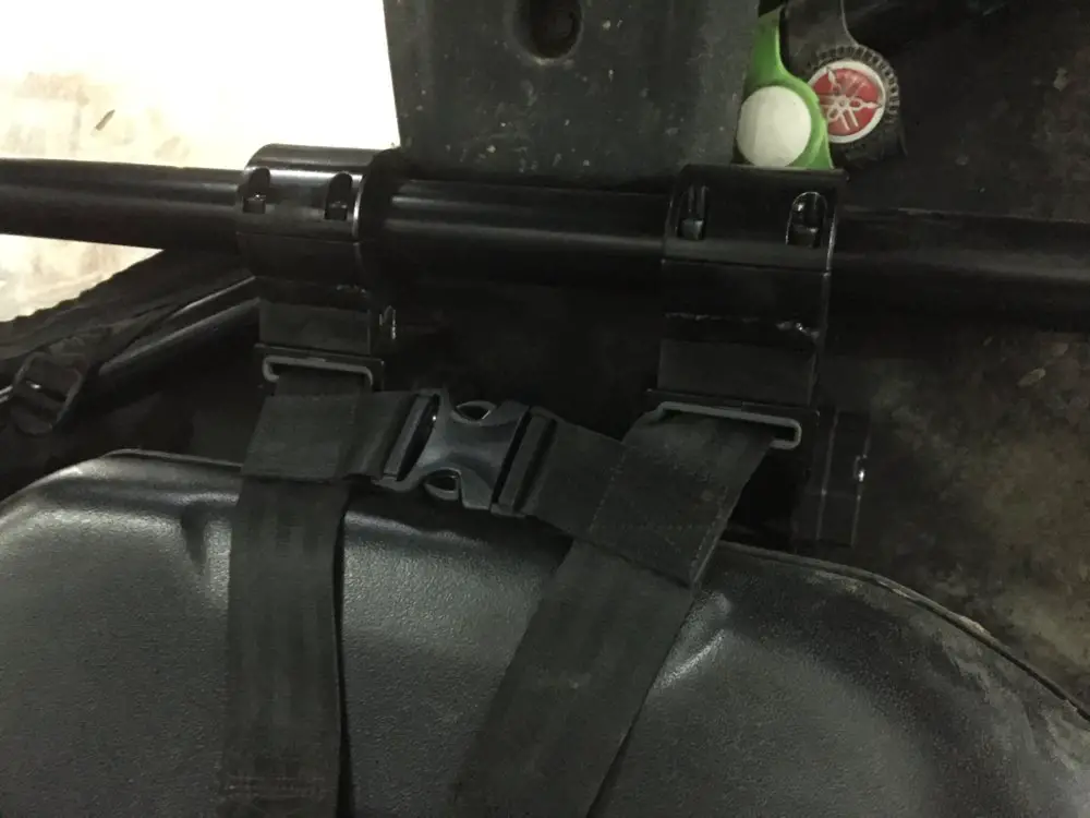

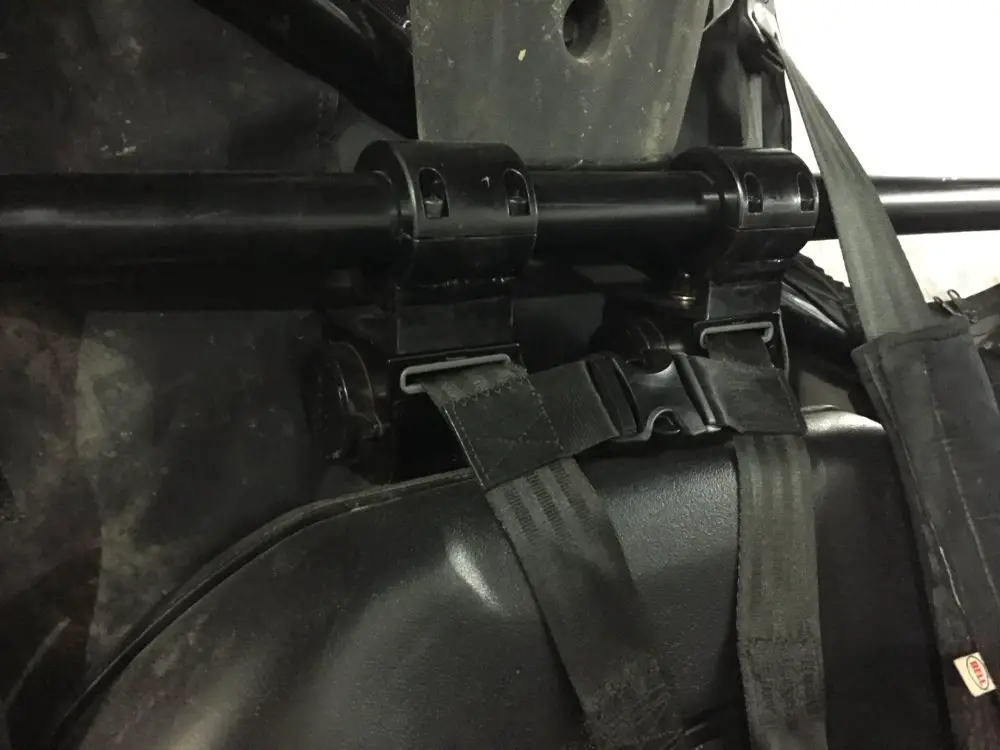

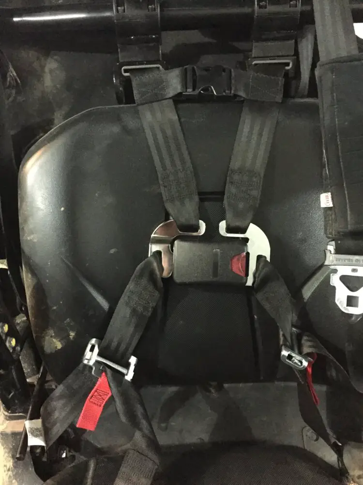

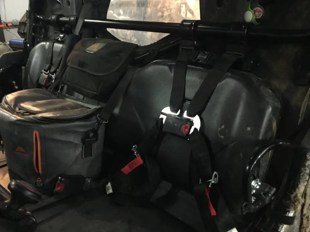

4 point for kids and use there nets ,and I wear my factory belt and I try not to act like a dumb assView attachment 108304View attachment 108305View attachment 108306
Hey I like your set up. It looks like you didn't use a harness bar for the rear... did you just strap the top to the bars on the seat? Where did you connect the bottom and where did you buy those harnesses? Sorry for the questions, just wanting to do the same thing you did.
Reactions: BWAF
I just loosened the floor from the seat Looped seat belts around tighten it up and then the bottom I just took the factory Clips off and four points right back through the same holes kids love them . If we do some serious riding I have taken ratchet strap around the back seats the bars I thought eye bolts to floor would work too

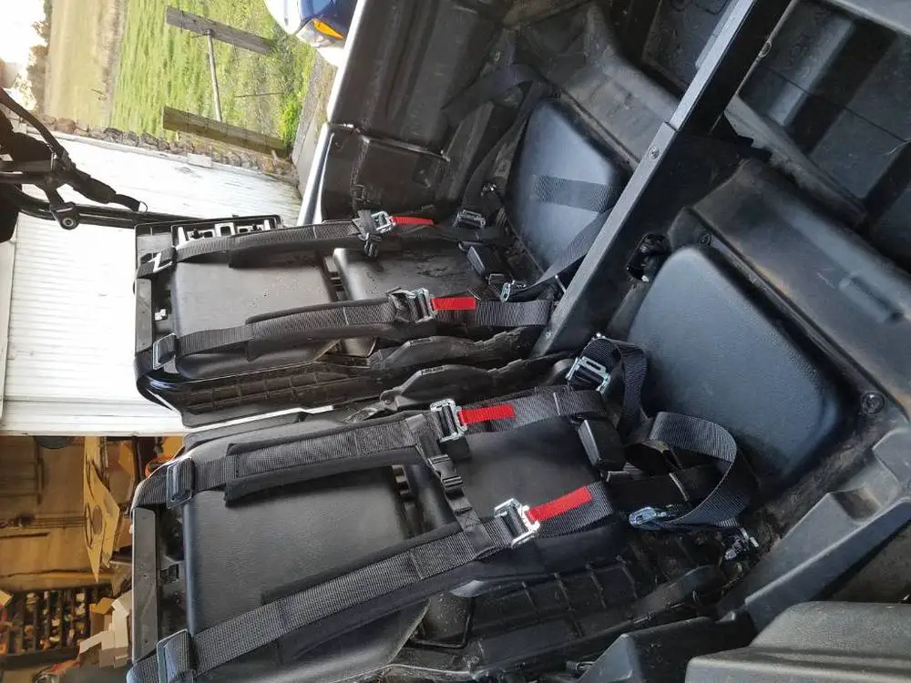

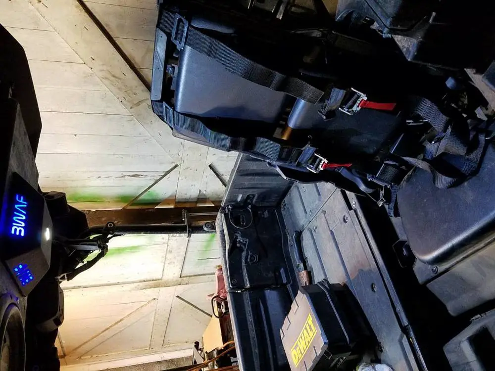

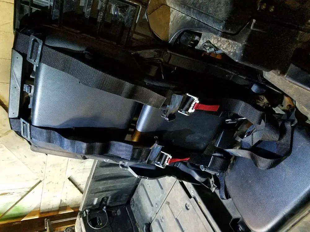

I used Velcro straps for the tie downs.... one on each side and two added to the back through the handle hole. Just nail the Velcro to the wood and wrap to put on, unwrap to take off! ......... eeezy peezy.
