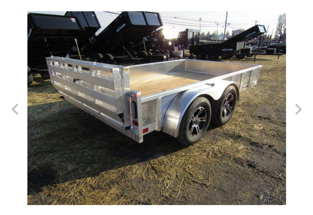

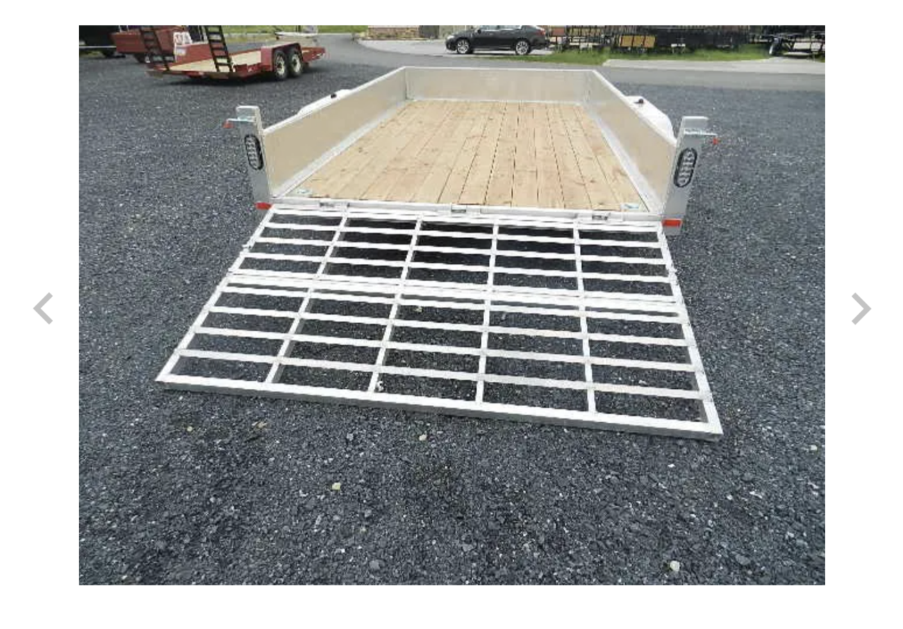

Post some pics of that trailer please. Will help us come up with something
I don't have any pictures of my trailer, but this is the exact same model. Decking is, I believe, 2x6 nominal:
