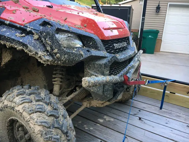

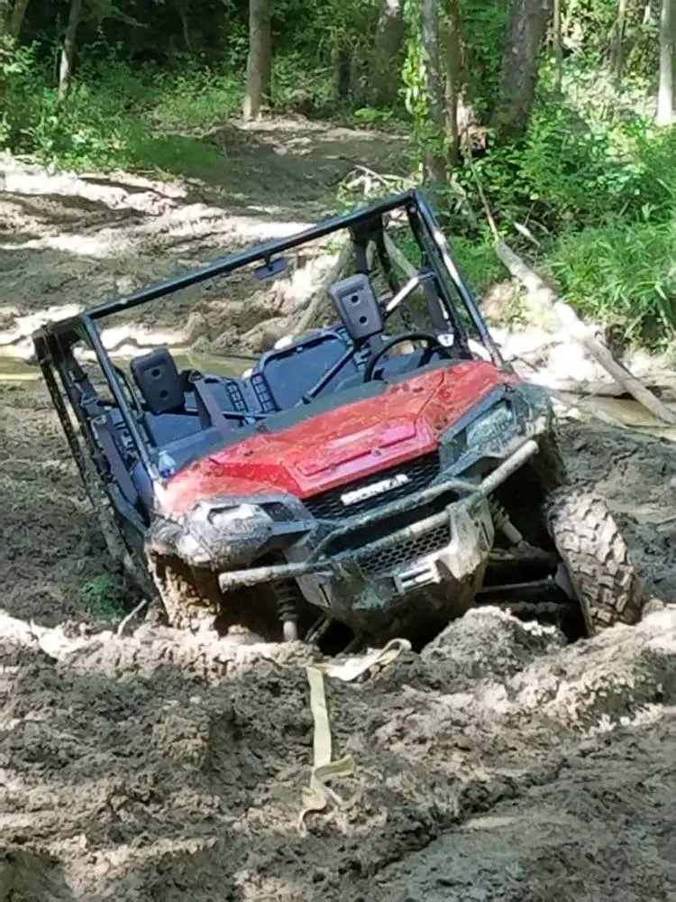

Looks like my winch bumper fab job will be sooner than later. I sunk the p1k5 Saturday. We were at Rush Off Road in KY and I got about 2' too far to the left. First try to get out was with an Arctic Cat Wildcat hooked onto me. Spooled out his winch rope and with no tow hooks I just hooked him onto my winch hook. He tightened up on it and my cable broke. I got out my tow strap and wrapped it around the upright and tube. Hooked the other end on a can am maverick x3, pulled the cat in front of that and hooked him up. They moved me about 6" and you can see the bumper carnage. Some more folks came by and a dude stood on top of a highlighter rzr and put a snatch block in a tree. We hooked his winch onto my to strap and hooked a teryx 4 onto the back of the Rzr. Came right out with the new angle. I'm replacing my cable with synthetic ripe and working on my new bumper design. New one will have two tow hooks and the winch mounted on top. I'm thinking about using the round tubes from the stock bumper on the top of mine. We will see........C27487d04f235b5ce98e2713ab36a60879e5cae996ed4cd03ca3bb1486c59f49

That's very impressive because me and Delton have stalled a super winch 4500 pound with it double through a snatch block hooked back to the top tube. His was hooked in the center of the top tube so I'm not sure if that would make a difference or not.

That is an interesting angle/twist to your front bumper.
