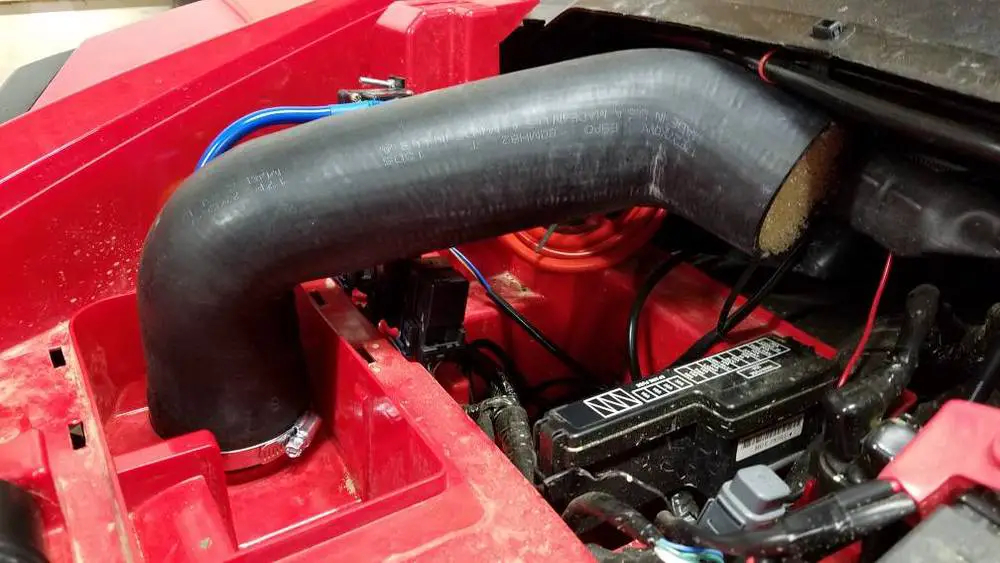

Got the stealth snorkel on this evening. Shouldn't have to worry about splashing any water into it on an oops and it raised it up a few inches. Af0bb5a79030cdd7c645f1ac9f3e0d4dB46598fe27957806abbca207ecb38331

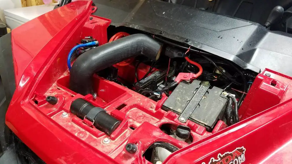

6b7dd8e9be0b4917f6ae482233ac8414
Slowly but surely crossing things off the list, and adding to it......

Make sure you pin the filter in place. It'll suck the little bugger all the way into the airbox.
What do you think, put a screw through the hose into the filter?
When i had the underhood snorkel i drilled a couple small holes and ran a piece of wire through it.
Thanks for the advise. I will do that tonight.
I drilled 2 holes and put a piece of coathanger through it. Bent it over and put a wire nut on each end. Black taped around it.

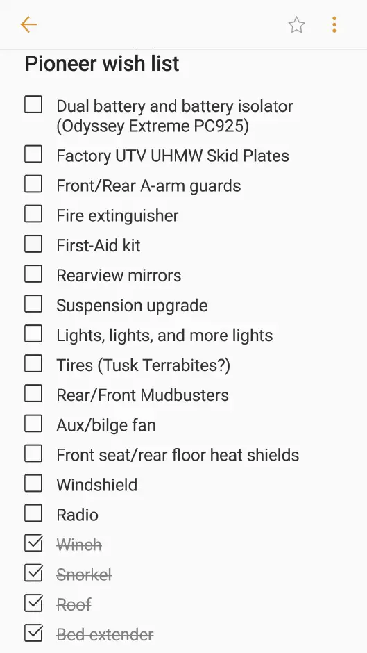

8321d30cd14f45146d249b50c729bf68
After the ride this weekend I updated and prioritized my wish list. Being on this site is getting expensive. A while back I would have looked at some of these trails and said, "I can't go up that". Now, that I've seen these rigs in action in the pics and vids on here, and put some miles on it, I say, "I just need a set of tires and a couple inches of ground clearance".......... After about 11 years of no serious off roading I'm starting to get my mojo back! Man I needed this rig.

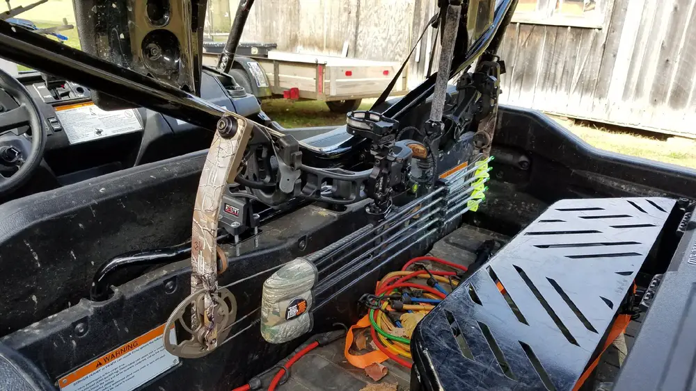

4c25bcc7f82dbce408722a470ee68c8f
After toting my bow around in a hard case all season. It was time for a quieter easier option. My wife bought me a set of Kolpin Rhino grips for my birthday. She’s the best! I️ put them on the rear passenger grab handles in the front of the bed. Worked out great.
