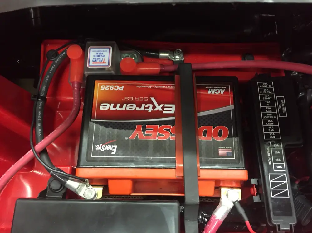

2nd battery and isolator in. Just need a few wire connections and I will have the volt meters hooked up for both batteries, then it’s time to start on the lights and accessories.
Public Service Announcement——- Don’t start your rig with a solo cup stuck in the intake hole..... I had one in there to keep me from dropping stuff into it. Started it to make sure isolator was working. Choked it off real quick. Took a few times of trying to get it started afterwards.

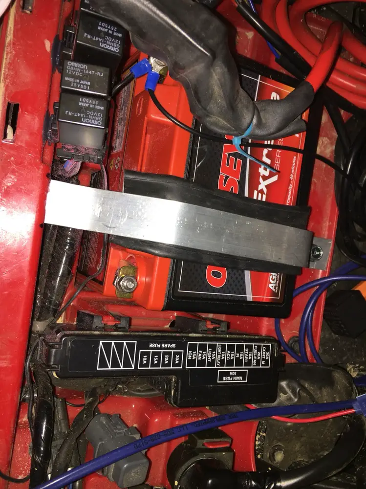

What have you all done for a hold down for the second battery? I’ve got a few ideas but not sure which way I want to go.
39,130
Not the prettiest but it works. I bent some flat bar to fit. It slides into a slot on one side and bolts to the frame on the other side. The bolted side is a ground location too.

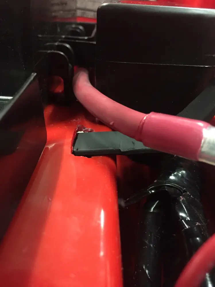

Baf65571f51700e00c69f0732cd0e463
Finally made my battery hold down @joeymt33 style.

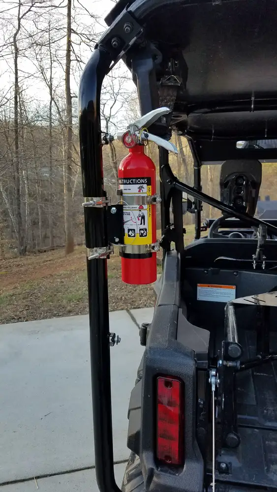

266653771816b287082c5311492e2a37
Fire Extinguisher.
