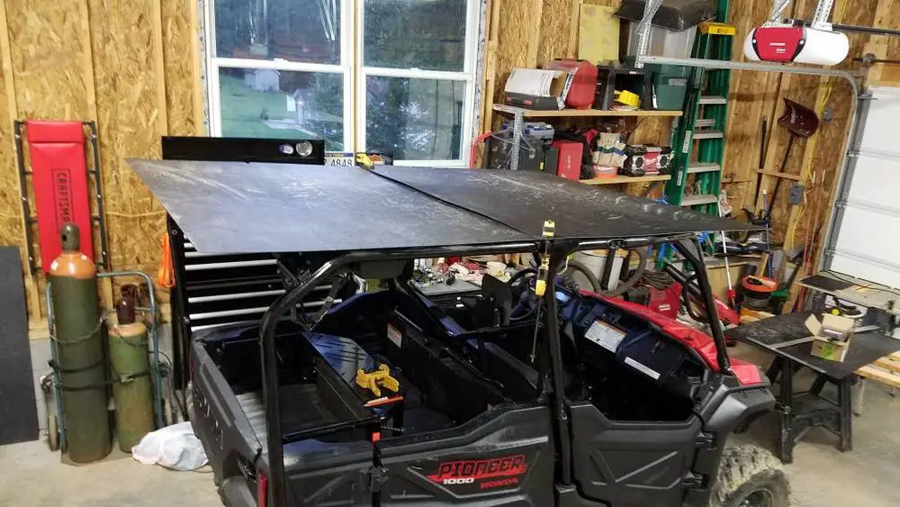

I got to spend a few hours in the garage today working on the roof. I got the back half marked and cut to size. I went ahead and drilled and clamped it. I ended up using the circular saw for everything. D7535541558b1d736e3c1bf99729bb7f86da3eb00a9fc2acd806837d27207806

Then i did the front. I let it lay on top and overlap the back about 4". This was enough to accommodate my clamps off the back of the center bar and the big flat washers I was using on top.14e3b7401c869ac82c8228c87b574a95

Then for the grand finale.....
I wanted to bend the front down for a visor. C-clamped a 2x4 to the front and went to work with the heat gun. I did some testing on a scrap piece and thought it would just bend with the weight of the 2x4 with a little heat. It wasn't quite that easy. When I got it close, I clamped it to the cage and left it for tonight. I think I will be able to put the rest of the P-clamps on tomorrow.356e4a6eb1593a5e4adbf00e56d0de3cE2120b75c793ec3526d2233f8cda2ae14af06ac8d72fc2f88065f0e160455384

I do have to take the front off and shorten it about 6" it hangs down too far. I also have to put a little foam between it and the cage in a few spots. I'm thinking about some kind of rain gutter across the front. Wife suggested spray painting a piece of vinyl J-channel black and pop riveting or bolting it across the front edge to keep water from running into our laps. I kind of like that idea. You guys have any others? I will also have to put a few pop rivets or bolts and where the pieces overlap between the clamp bolts.

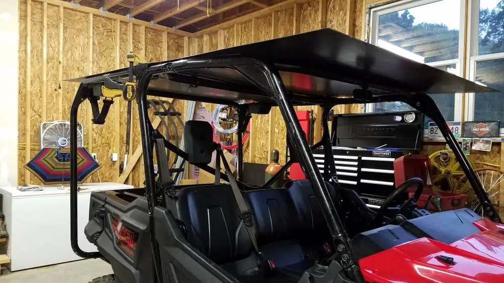

I got the roof finished today. It comes down about 5-6 inches on the front. I decided I needed something stiff across the front so I bought a piece of aluminum angle and a piece of aluminum flat bar. I sandwiched the ABS between the angle and flat bar and put a few bolts through it. I put a p-clamp on each end to hold it to the cage. The aluminum angle should serve as a pretty good rain gutter on the front too. I'm pretty proud of it. When it was all said and done, I have about 8 hours and $175 in it.

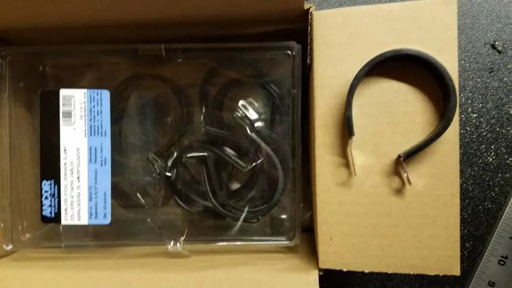

I haven't posted in a while. I told you this would be excruciatingly slow..... I decided to save some money on a roof and make my own. I decided on 1/8" ABS. I maybe should have gotten thicker, but I went with this yo keep the weight down. I had to buy 2, 4'x8' sheets yo cover it. I ordered 20, rubber lined, stainless "p" clamps off Amazon. I just have to pick up bolts and washers now. I cut it down to manageable sizes with my circular saw. Going to make final cuts with table saw. I'm planning to roll the front over 4"-6" for a visor. I will probably put some of the foam tape like goes under a truck topper between it and the cage and put rubber door edge trim around the edges. I may have to put a support back the center to keep it from drooping slightly, not sure yet. Hope it turns out good and lasts a while. I will have under $150 in it......View attachment 53459View attachment 53460View attachment 53461

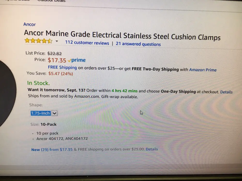

Where'd you order those clamps? I need sobering to mount my home made pvc speaker pods.
Amazon

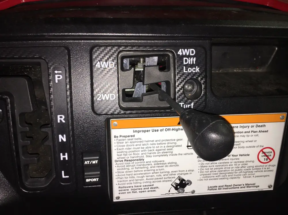

Finally got around to painting the shifter designations tonight. White paint pen from Michaels craft store.
