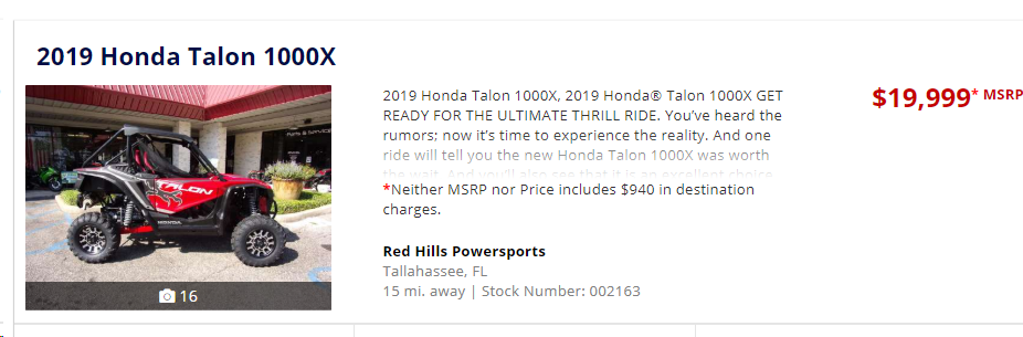

Then again.... :D
Upload 2019 7 31 13 41 9

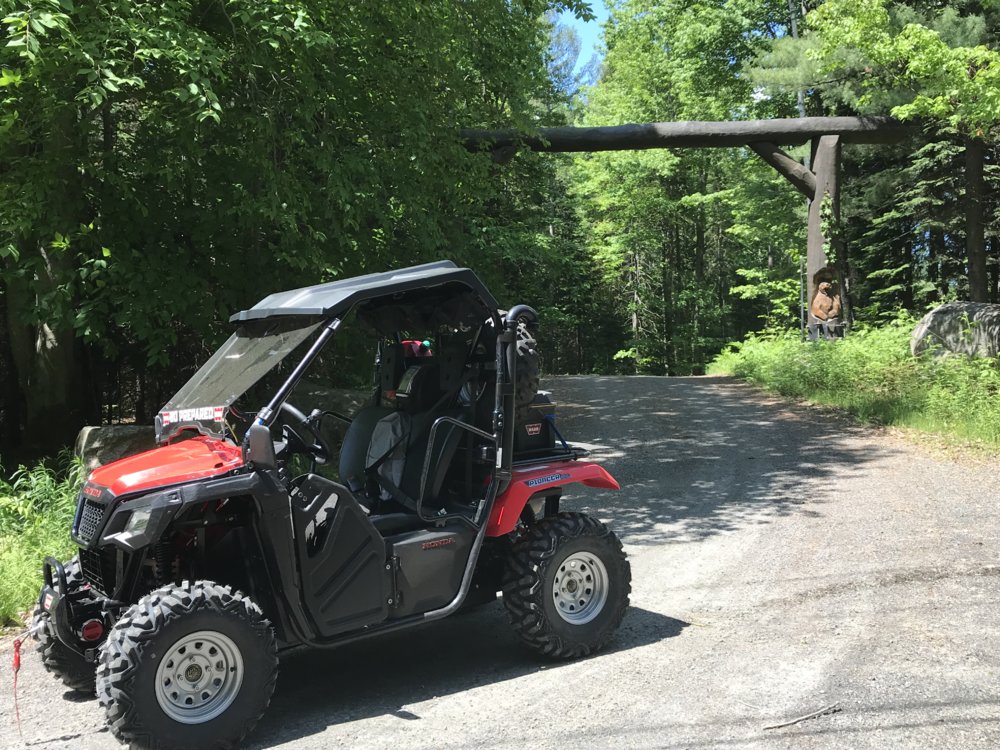

What can I do to improve the ride of my P500 without spending a ton of money?
So far I've upgraded to 27" radials, tire pressure is set at 6psi, I disconnected the rear sway bar...what else can I do? This thing rides like a little North Korean tank LOL
I'm coming from the world of Yamaha, and as far as SxS's, my last ones were Rhino's and a Wolverine. I know it's not fair to compare them, but to be honest, the only reason I sold my Yamaha and bought the P500 was its small size. Had I known it rode this rough I might have made a different decision.
Again, money is a key issue, as I don't have much of it :(
Pic for attention...
Not much more you can do without spending a bunch on new shocks, mine is all stock but as with anything else it just a matter of getting used to it. We ride a lot of 50" trails and you can't go very fast so the firm ride is not usually an big issue, faster speeds yes but you get used to it and I have had 2 back surgeries.
