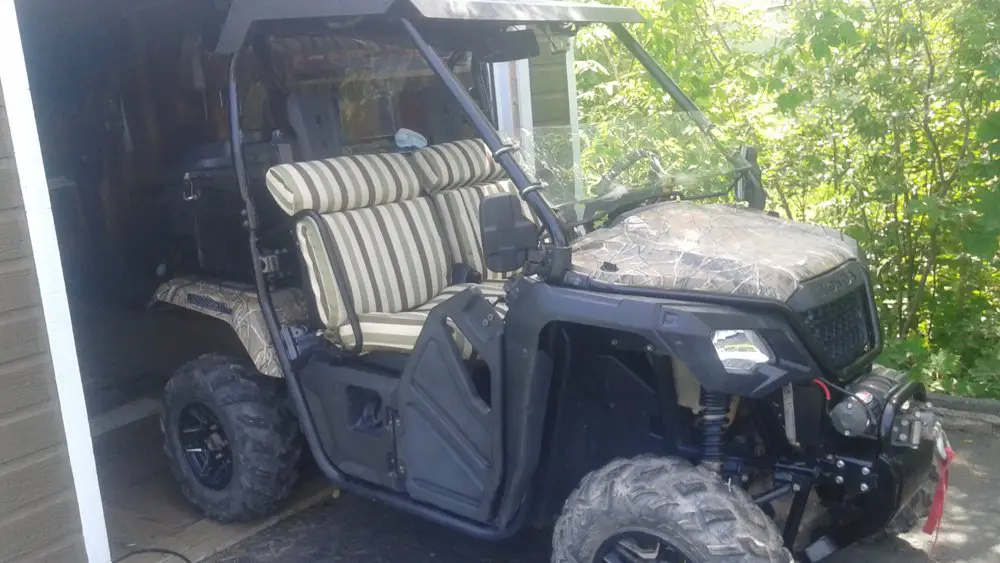

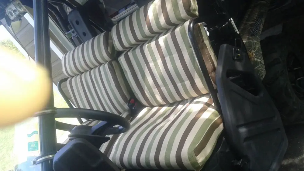

this what i use to improve ride quality on the cheap..
Like night and day may look like crap but way better on the back and the arse.
View attachment 152794 View attachment 152795
Looks like the cushions off my outdoor patio furniture. Did you set'em on the existing P500 seats or did you remove the P500 seats and put them in place of them? Can't tell from the photos? Great idea.
Actually that's where they came from patio furniture.My wife father gave them to use said try these no one uses them and they fit perfect over top of the seats and i have a little strap the attach with velcro in the back of the seat.
