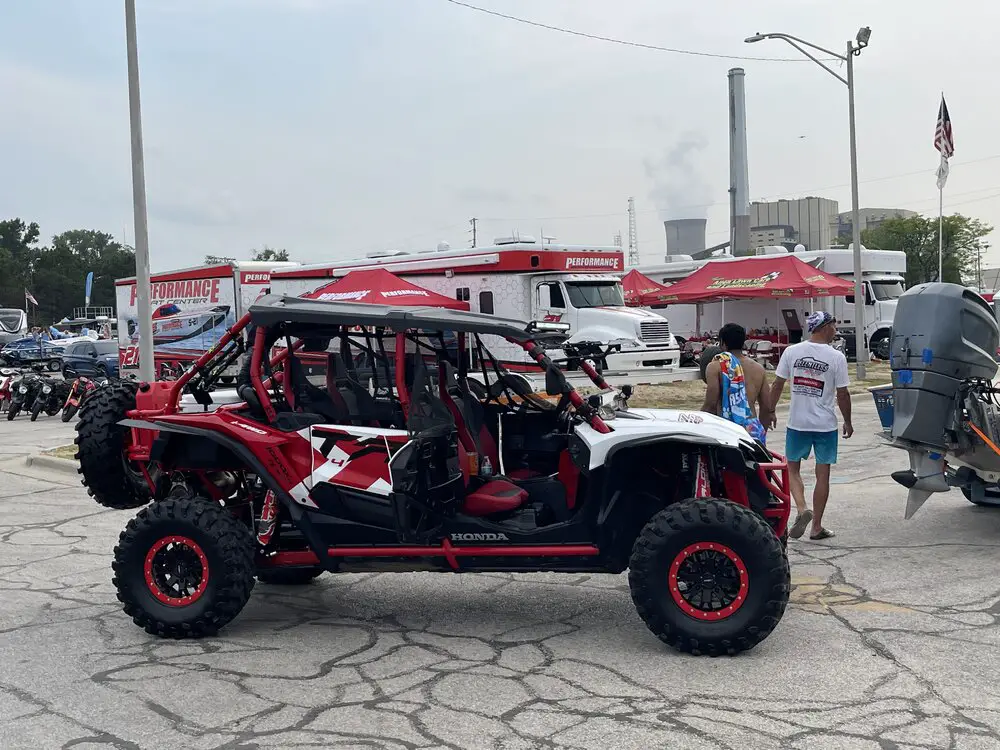

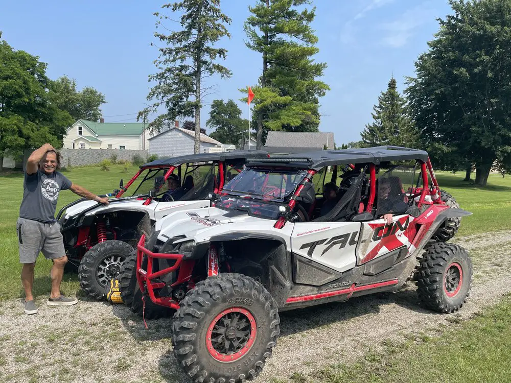

The 500 miles were put on between Posen, alpina, st-Clair, and Michigan city. We race Offshore Racing boats (Team Woody) and we’re on the north leg of the series so packed up whole family and had a Race-Cation. It was awesome.

My buddy owns a Talon also so our trail speed was matched. We were running them hard. These rigs are trail beast and fun as heck to row gears through the trails. Motor is a tad soft with 32’s, 4- average sized adults, and trailer gear. Thinking turbo would solve the drone isssue and lack of power?
