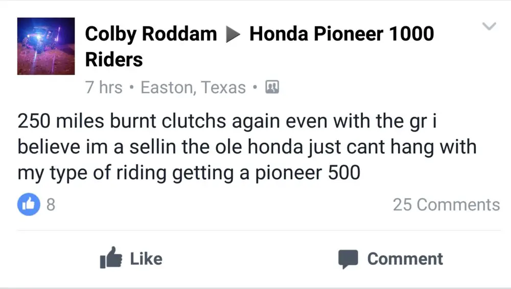

Just seen where a guy who installed the internal gear reductions just burnt his clutch up again.
Not sure how big of tires he is running but I just don't believe these machines were made for extreme mudding that some people use them for. Especially with 30"+ tall tires.
I have only run the 28" x10" x 14" and have went through 2 clutches, a right rear axle and a left front axle. I don't even get into mud unless absolutely necessary. My point being, I wouldn't recommend throwing a ton of $$$ I to the P1K and expect it to do something it wasn't designed for with tires 30%+ bigger than OEM. It just isn't going to hold up, these machines weigh so much more than an ATV the stresses put on the drive train is going to let something give up the ghost.

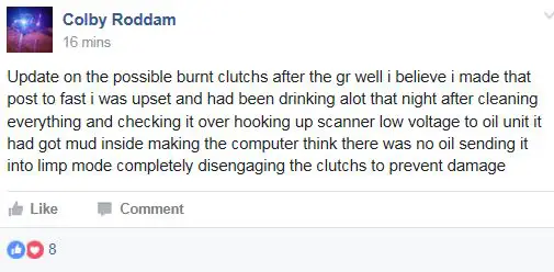

And now for the update on this...
IGR Update
ButchersHook
ButchersHook
May 13, 2015
167
332
Unbelievable, 15 pages of why the clutches are burning up even with "IGR".....And its because he had "Low voltage to oil sending unit"!!!!
You read these forums and either wanna spend more money on your Pioneer, OR you read these forums and wait for something to fail cause it happened to someone else....

A false reading could cause limp mode but would not burn up clutches lol. What a joke
