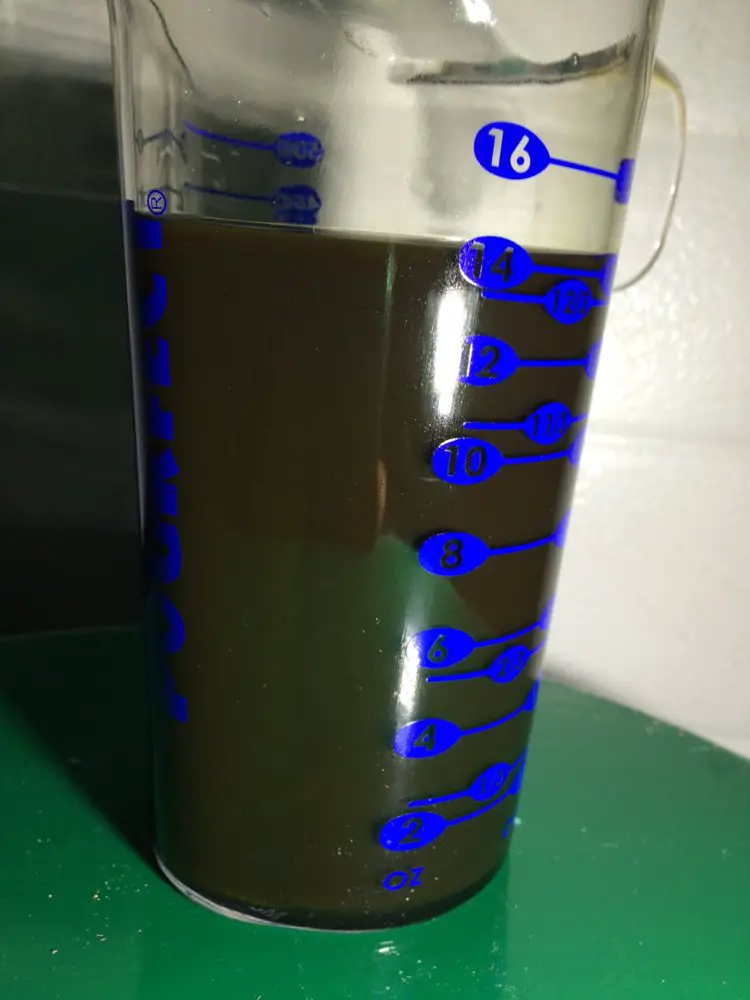

My question is to the people who have had clutch issues mostly? I know that a side effect of slipping clutches is discolored oil cause the oil gets a little clutch fiber residue suspended in the oil way before clutches start to majorly slip as I have found in the drag racing world where clutch slip is a science!! So did most of the guys with clutch issues have the problems before or after 1st service and if it was after do u happen to remember the color of your oil during or close to 1st service? I have 78 miles on mine and just checked and the oil is PERFECTLY clean with a bright yellow look on the paper towel and I broke in nice the first 4 hours and normal to hard riding after that. ????? any and all oil color references wanted thanks.

I think most people that had clutch failures also had very dark oil.
Reactions: CumminsPusher
35,445
208,731
my oil turned dark when my clutch went
I'll be watching my oil from now on, I think Honda needs a really tough 1-3-5 clutch. It's weird I was babying mine and at16 hours the oil was bad.

Well, digging up old threads... but is it related? I read through the posts... still undecided.
