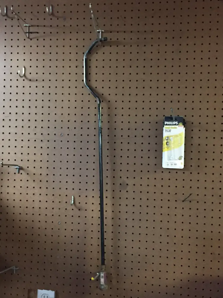

Somewhere I have an attachment for a hose that is essentially a long wand with a 90 degree bend in it. I think I got it at an auto parts store (like Auto Zone) years ago. I'll try to dig it up, but I used it to clean the frames of Jeeps etc. insert the end into the frame and turn on the water.
I have also used it to wash radiators out from the back side. Worst case, you could make one out of pvc pipe
Found it while doing a little hurricane prep
16144b2f4eccd871675e2c79f857da2e
Reactions: JTW and elkguide
