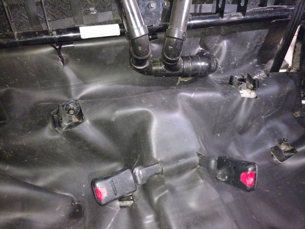

Everyone should do this to a P5 and most have. Rode @Remington 's when he first bought his and it didn't have a barrier, forgot how noisy these things could be. Several ways of reducing the noise and heat. I've tried a couple of them and found that thin rubber works best.

Thanks trigger. How thick is it. That’s great for the summer up here. I’ll take it off in the fall. Haha

I just recently installed the old heat and noise barrier from @trigger on top of the one I had already made. I'd say the combination of the two is nearly 3/4" thick and boy does it ever cut down on the heat and noise! Thanks Trigger!

Wondered if you ever got around to using it, anytime brother.

Does it get sticky from the heat,?
Not at all and the best part is you can power wash the machine and leave it in. I put two little holes in it where it sags behind the seats, what little water puddled now drains out. I actually just cut a new one and giving my old one to @Remington . The only change I've noticed is that it gets a little stiffer over time but not to the point of cracking or anything.

Do you get the rubber stuff at the big hardware stores, roofing section. I'd imagine?

I don't know if the big box stores carry it or not. I get it from whichever roofer is working for me at the time that I need it. Don't know if you guys have Wimsatt down there but they might carry it. Or just go by a commercial construction project and you'll probably find enough in the dumpster. The amount we need is nothing for a roofing company. ;)

Hi trigger. Got the EPDM. Thanks. Just wondering what you did , if anything, to keep it in place on the sides and the front. I see the tie wraps for the seat posts and seat belt and the back but. Ant tell wats going on in front and the sides. I was thinking maybe Velcro. But would it stick. Give me a shout back when you can. Thanks again for the tip.

It just stays where it's at once you put the seat in place. It's not a super light material so it stays in place pretty good.

Thanks trigger. Got it tie wrapped to the back and starting to cut for the seat posts and seatbelt. Thanks again.
