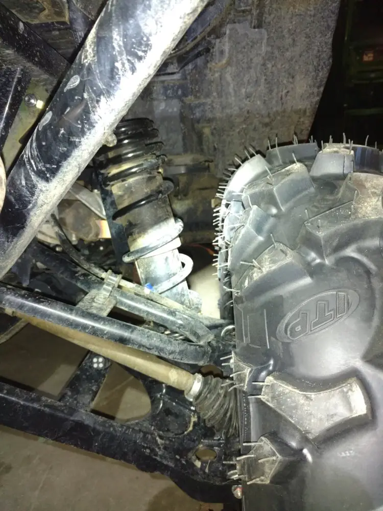

I also installed HL arched/forward a-arms on the front
Well everything fit great no worries here!
IMG 20170110 203143447
B
Boomboom907
Apr 27, 2016
596
620
Washington
12 inch rims don't fit with the stock tires and hl lift.
All you need to do is jump to 14 inch rims. Lift changes the angle of the shock. Pushes it closer to tire. Small rim diameter hits middle of shock. Bigger rims overcome that.
I did this without my new tires and had a ride planned the next day. Ended up spinning the tires around and bolting them on backwards so I could make it the next day.....
Yeah. Valve stems got all f***ed up. No it didn't work. Yes I had to turn around after fifteen mins. Yes it was a waste of time. No I didn't learn anything.

Hey guys I'm new to the forum. Need some help. I just installed a Highlighter lift on my 1000-5 and now my rear shocks are hitting the tires! It's sitting on stocks right now while I wait on my new tires/wheels to come in. My question is will the new wheels be offset enough or will I need spacers. I have a big ride coming up and need this fixed ASAP.. Thanks guys.
