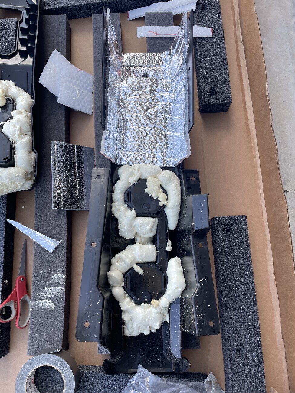

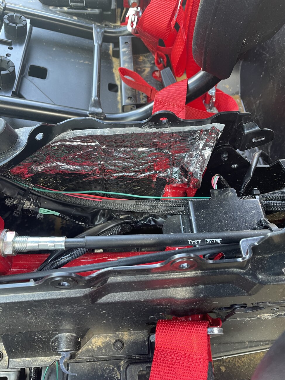

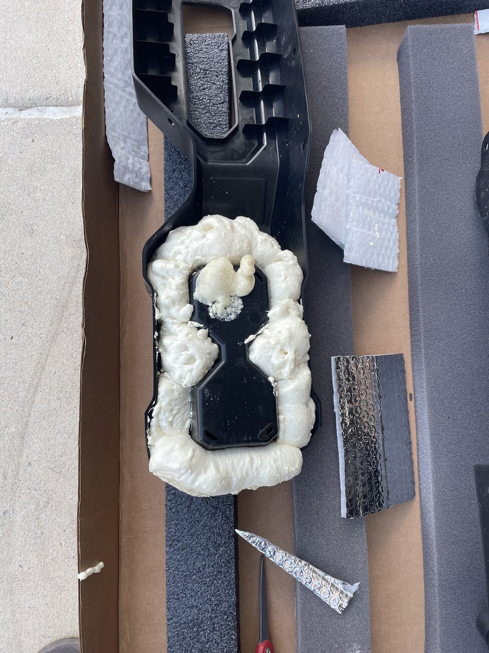

Added some heat shield (not trigger quality) and some spray foam… we’ll see how that helps with the heat… best I could do with what I had…
