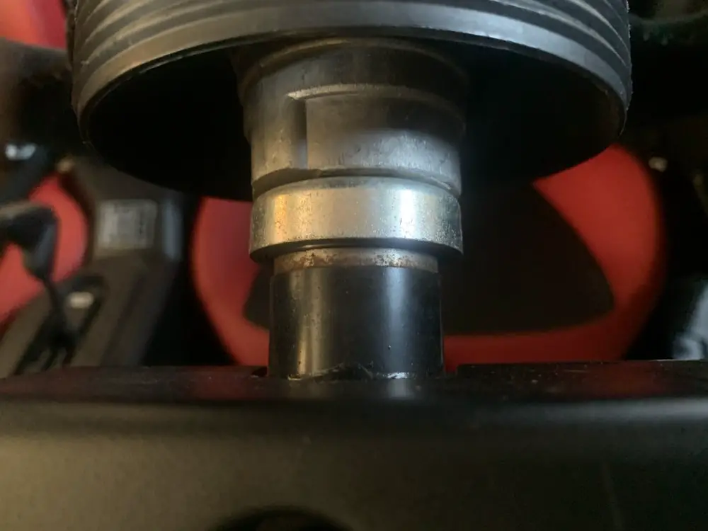

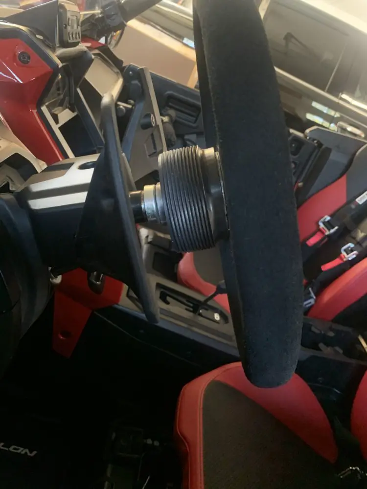

View attachment 178495 View attachment 178496 I finally took a couple of pics this morning. I hope this helps. Like I said I just measured the stock setup and cut my adapter several times until it had the same measurement as stock
Thanks MFG for the info and pics. I ordered the same wheel and hub you did. Est delivery on the wheel isn't until mid to late February but no problem since the ATV/UTV trails here in Vermont are closed until spring. Hub should be here next week.
Noticed in the pic that you have changed your shifter gate. How do you like it?

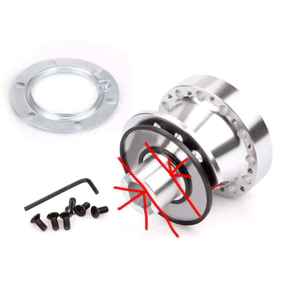

Thanks, and yes the paddles are the same distance from the steering wheel. I can try to get a picture tonight. This is a different adapter but the picture shows what I cut off. I measured from the factory wheel before I started and then made several cuts on the adapter until I cut off enough for the new wheel and adapter to be the same measurement as stock. The splines are deep in the adapter so what you cut off does not mater.
Thank you!! It's true, a pic is worth a thousand words.
