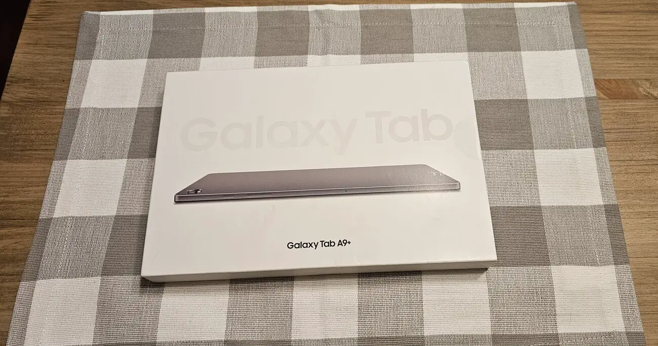

Took advantage of the rain for an easy "install."
We needed a tablet dedicated to the Talon so we used some rewards points and got this for $8.12 out of pocket. Now to order the Lifetime Trail Maps software and a waterproof case.
My trail maps will be here next week. I ordered the whole deal from them. Hurry and get it done and you can come to Indian Mtn. Easy day trip for y’all

🤔 You had to order trail maps?........ would've thought a regular GPS would get you to the Mall and back no problems 🤨
It was actually much cheaper and you get a better grade tablet by buying the tablet outright and then purchasing the maps.
My other tablet spends most of its time updating. It’s 4-5 yrs old now. I just wanted this way because I called and talked to them this way if tablet gets stolen, destroyed or something I don’t have to pay for replacement maps. If I download them and something happens I gotta buy all over again. Plus it comes with a case and everything. I really like my new mount. It’s much better and looks factory. Money well spent.
