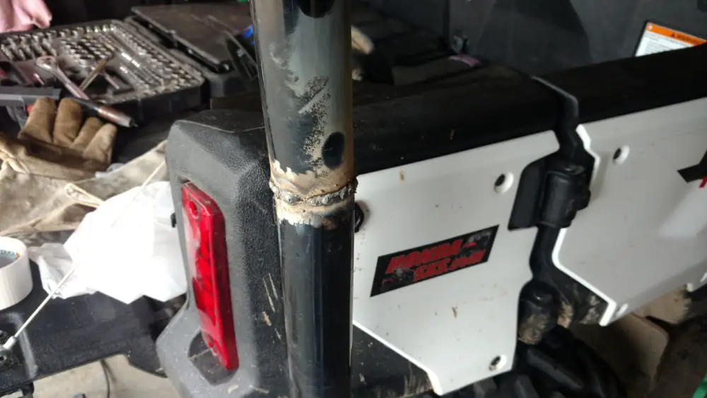

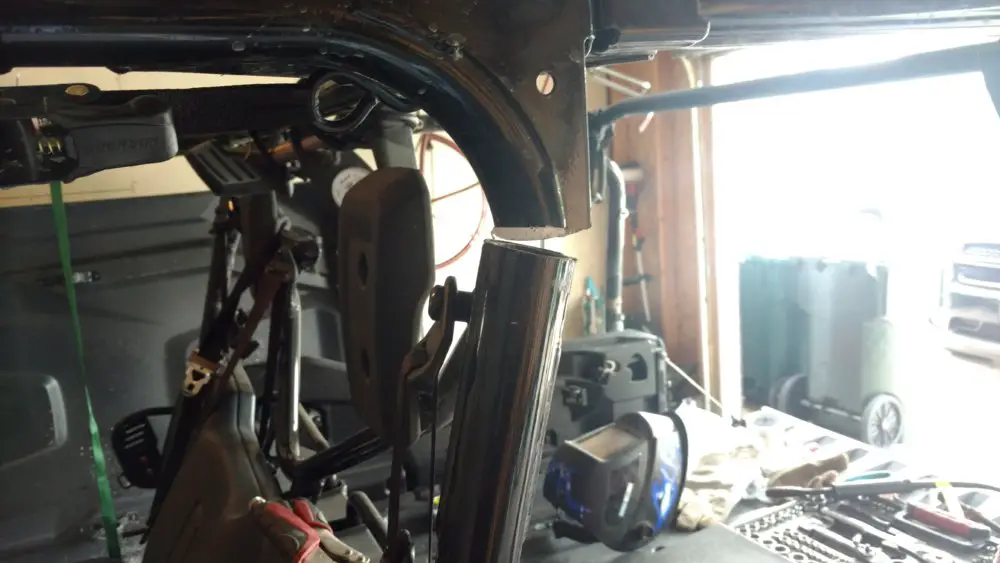

Progress on the chop top so far, everything is lining up nicely after I cut 1.5 inches out if one c pillar to fix my boo boo. Everything but the b pillars are welded up now. Don't judge my garbage looking welds, I'm rocking a harbor freight 110v welder, they're ugly but solid.

Looking better Mopar! You've got penetration so that doesn't matter.

Agreed

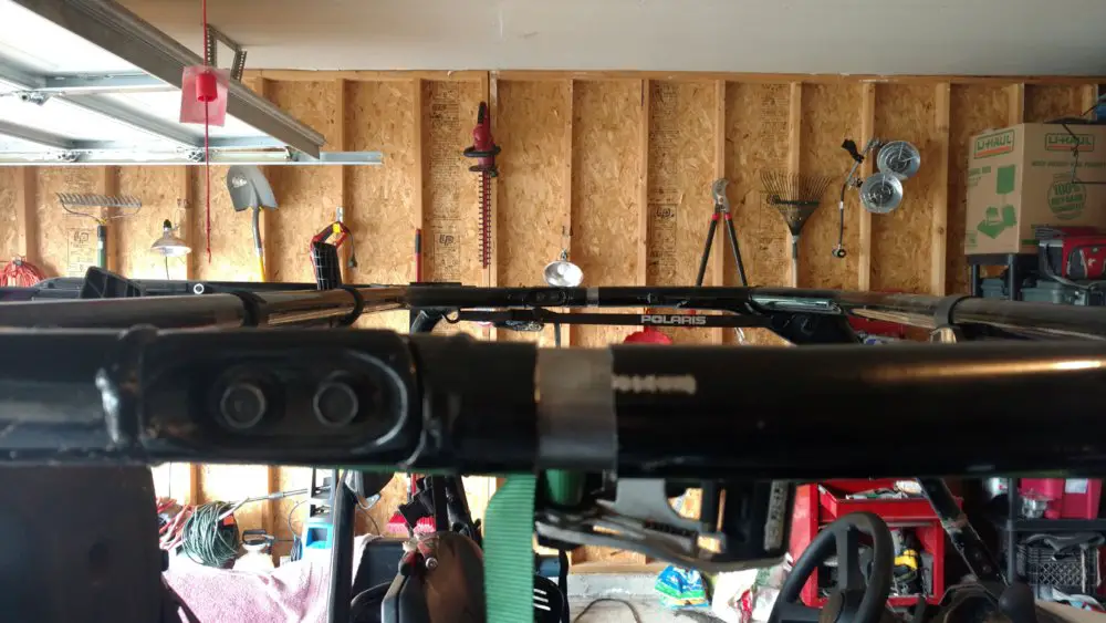

I think the profile turned out just right. Final amount of cut was 5.5 front 6 rear. Sits perfectly flat
View attachment 20300 View attachment 20301 View attachment 20302
That's the same welder I used when I added the back seats, had never used a wire feed before, always used a stick welder in the past.

Hold the nozzle closer to your work, turn the wire speed down a hair and make sure the metal is CLEAN! You can minimize the splatter that way, but it will never go away with flux core
