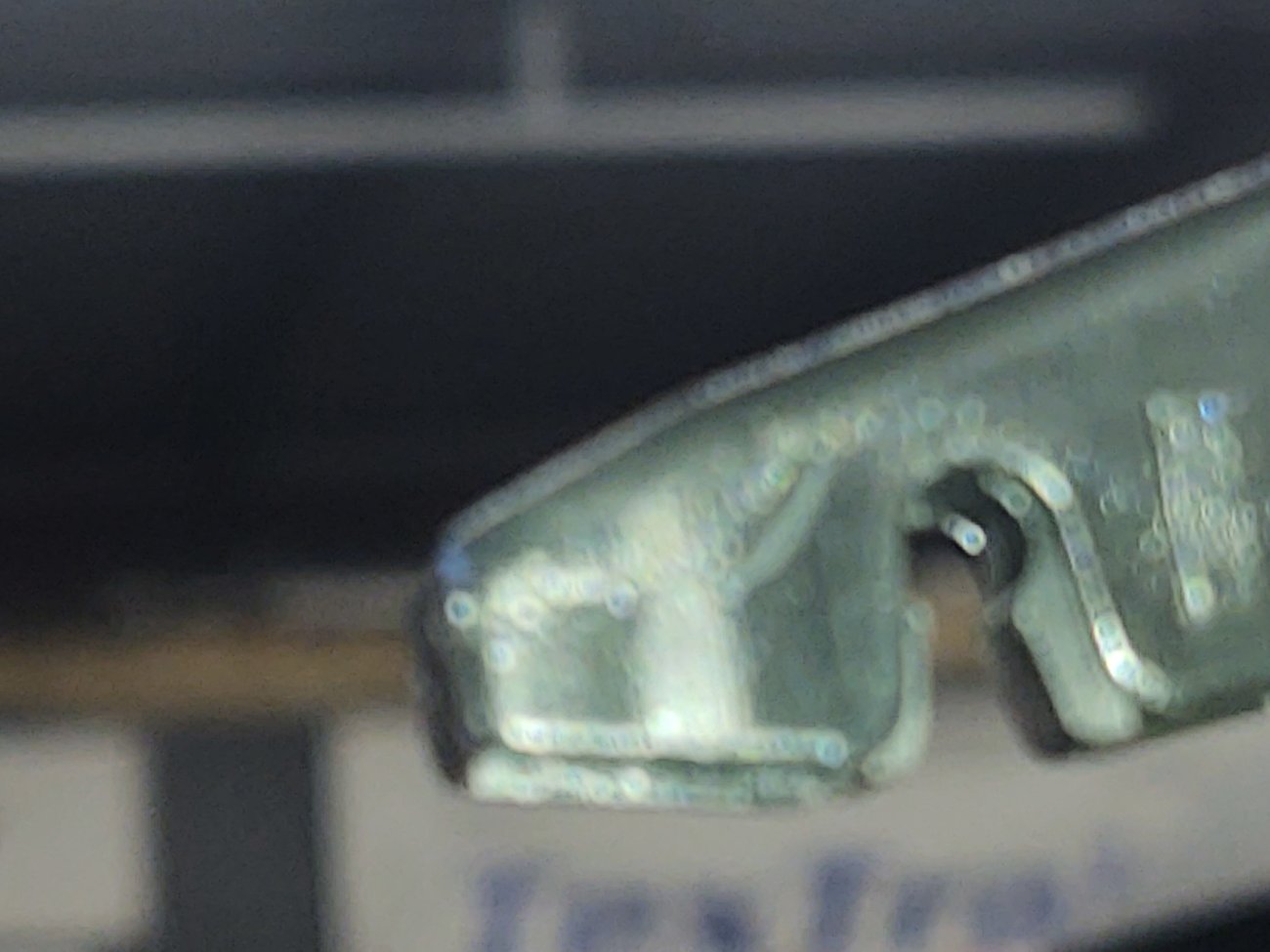

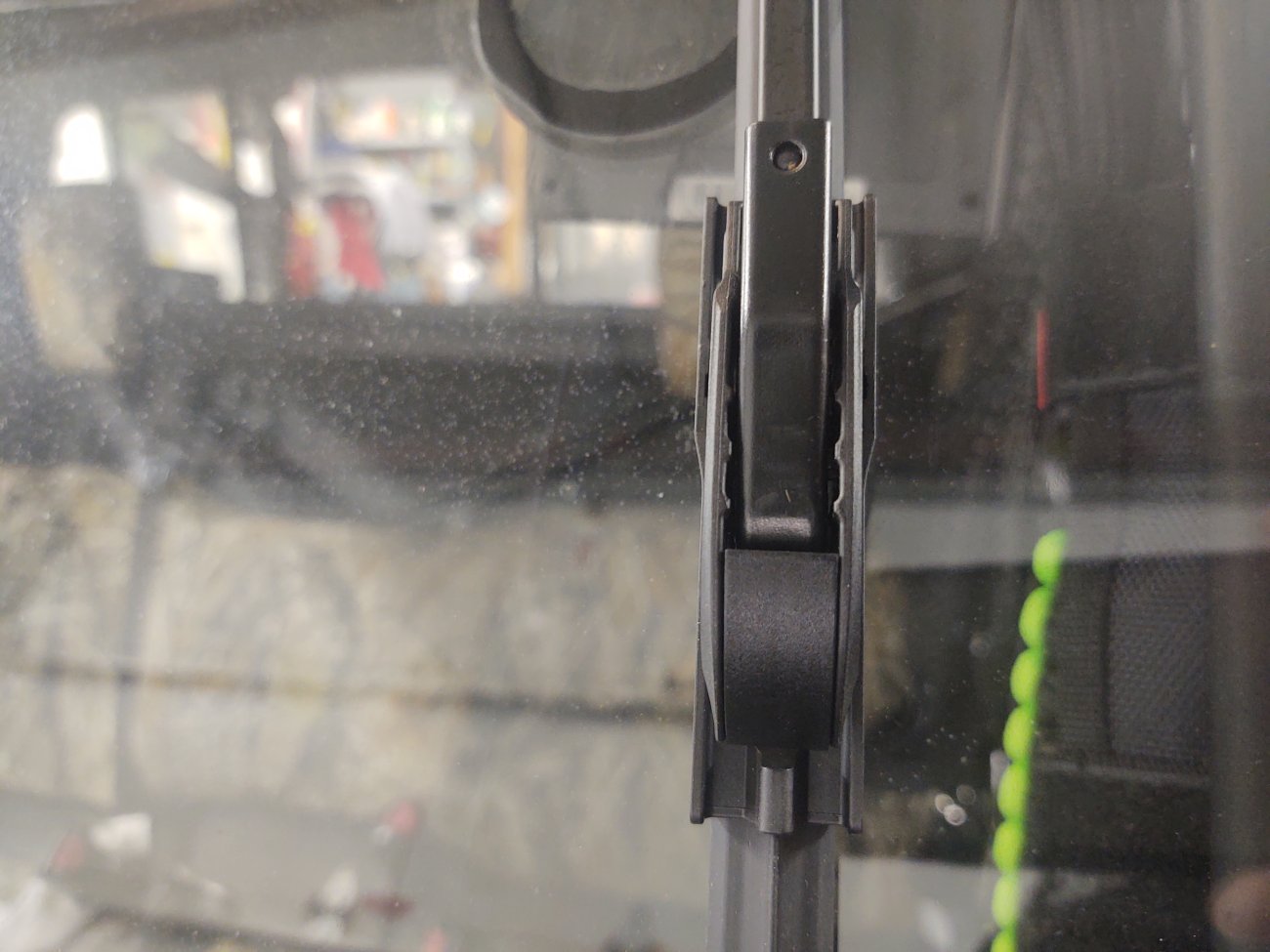

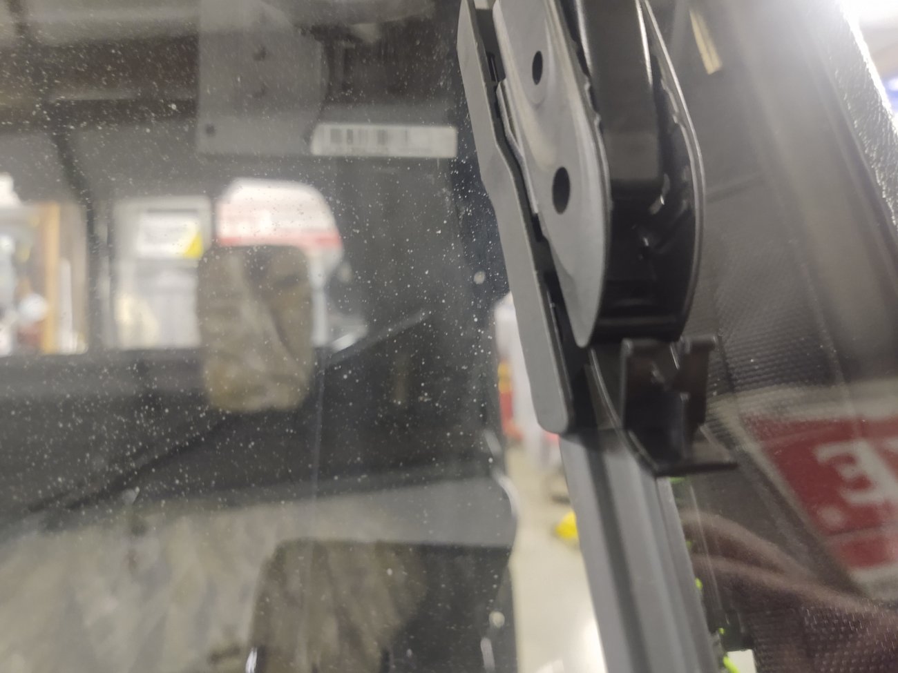

I want to replace the 12" blade with a 14" blade. The blade has to connect onto a round bar. I cannot find a blade that does that. Replacements are small nor large J hooks, pin arms, I&L pinch tabs,P&H, PTB, I&L clone, narrow P&H, narrow PTB. None of those match.
Pics of the OEM blade and arm connection point.

Sorry. I was trying to be sure and include pics.
I'm trying to find a 14" silicone bade replacement... brand and model, like Rain-X silicone Endura
No worries. Was just a little confused. Did u try Amazon?

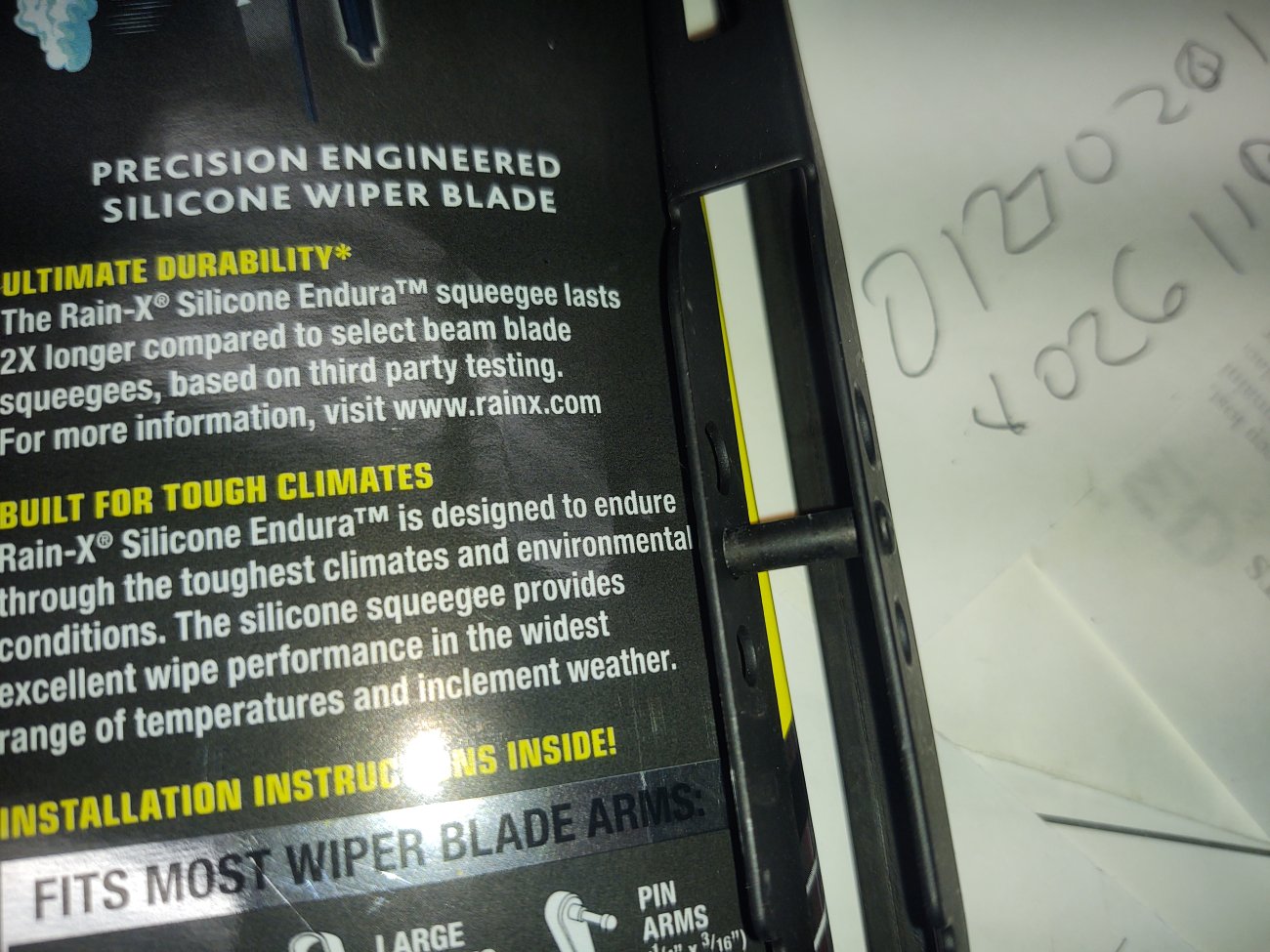

IMG 20230404 174247633IMG 20230404 174215581
Boy, I got knocked down a peg.
At NAPA, there's a little grandma lady who's been there at least 40 years. She's very impressive. I showed her my OEM blade and photos of the arm. She snapped off the plastic adapter on my new Rain-X blade........And, said, this is an adapter for a J hook that I snapped off...and there. underneath was the straight bar, like my OEM blade that I needed. She said, that should snap onto your wiper arm and the top will fold down and lock it on. And, it did. Perfect. Being able to do literally anything, I was bamboozled by this. I paid for her lunch. She learned me something.
