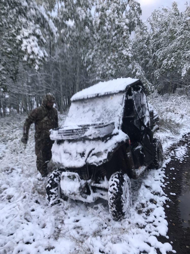

Just returned from 10 day elk trip in Wyoming. The P500 Rocked!!!!!! The amount of stuff it would do even impressed the other guys in camp. I realized that I have made a great choice after this trip. Climbed/pulled/ snow/mud/ sips gas, handles Tight trails. I honestly believe this is the most capable versatile little sxs out there and without a question the most bang for buck View attachment 54580View attachment 54581View attachment 54582

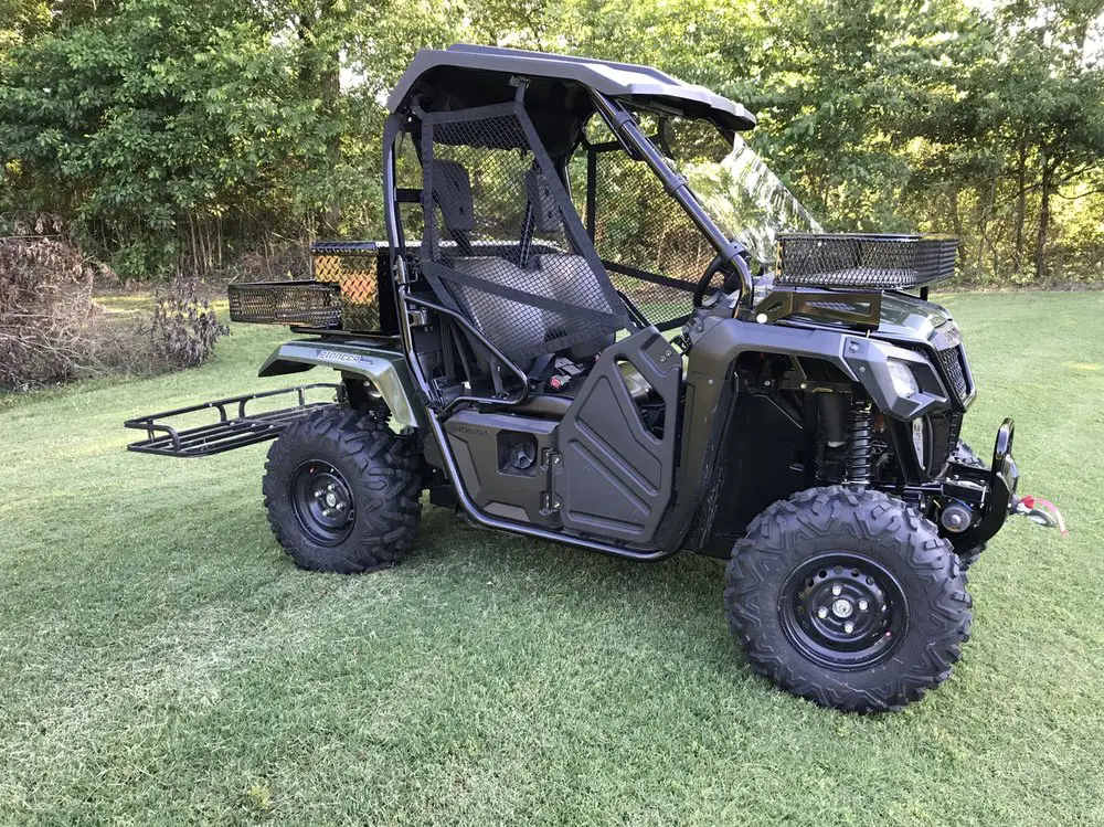

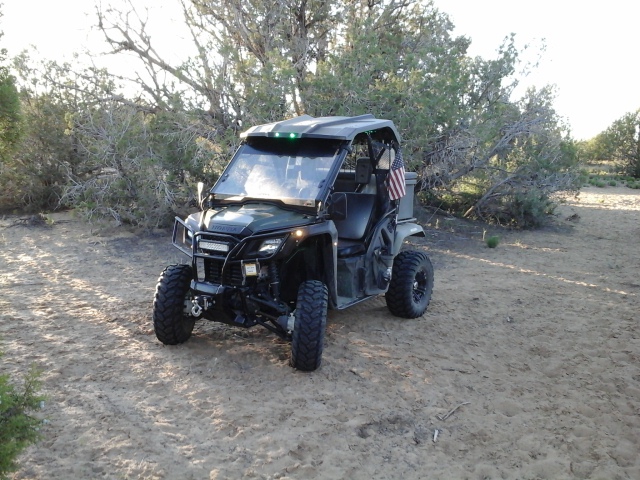

I have to agree. My P5 has 26 inch Big Horn tires, 12 inch wide on the rear. It also has 2 inch spacers all around making it about 56 inches wide. I’ve done a lot of math on the CG and roll over angles. The tires increased my ground clearance by 1.5 inches to 10 inches from 8.5 inches. WE shocks all around also, but kept same preload as stock shocks. Working backward from the original 33.5 inch roll over angle, my new roll over angle is 35.3 degrees. This assumes a fully loaded vehicle and rack load.

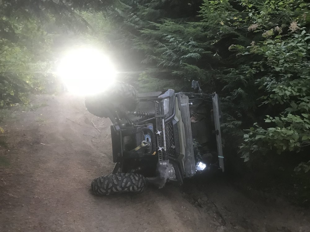

I recently slid into a deep rut on an off camber desert road section with just me and a moderate load in my Tractor Supply storage box. My inclinometer read 35 degrees, so I gently stepped off the rig and it was stable. I put some rocks in front of the right front tire that was turned into the rut and I was able to drive into the rut and straddle it to get out of it. I was really impressed with the P5’s capability on that side slope. I looked at it while dismounted and it seemed unreal that it was still stable at such an angle.
My hints for increased stability include: carry heavy items like recovery gear and tools on the passenger floor, increase the width, install an inclinometer on your dash, and carry a handheld angle finder to check side slopes if in doubt.

when I went to buy my P5 the dealer wanted to sell me a RZR. Took it for a ride. Didn’t like the engine winding up so high when barely moving. Bought the P5. 2 inch spacers all the way around, Walker Evans shocks and 26 inch Big Horn tires make it nearly unstoppable. It gets great gas mileage on rough trails......typically 25 mpg. I’ve had it at 35 degrees when a rear tire slid into a rut. Still pretty stable, but pucker factor was pegged. I keep my anti sway bar connected to help out on off camber situations. Run tires at 8 psi or lower and the ride is not bad.

I am adding 3" to each side-ride a lot in Arizona with mid/full size sis. leaned it over 1 time on a severe wash out-tipped it up & drove out.
