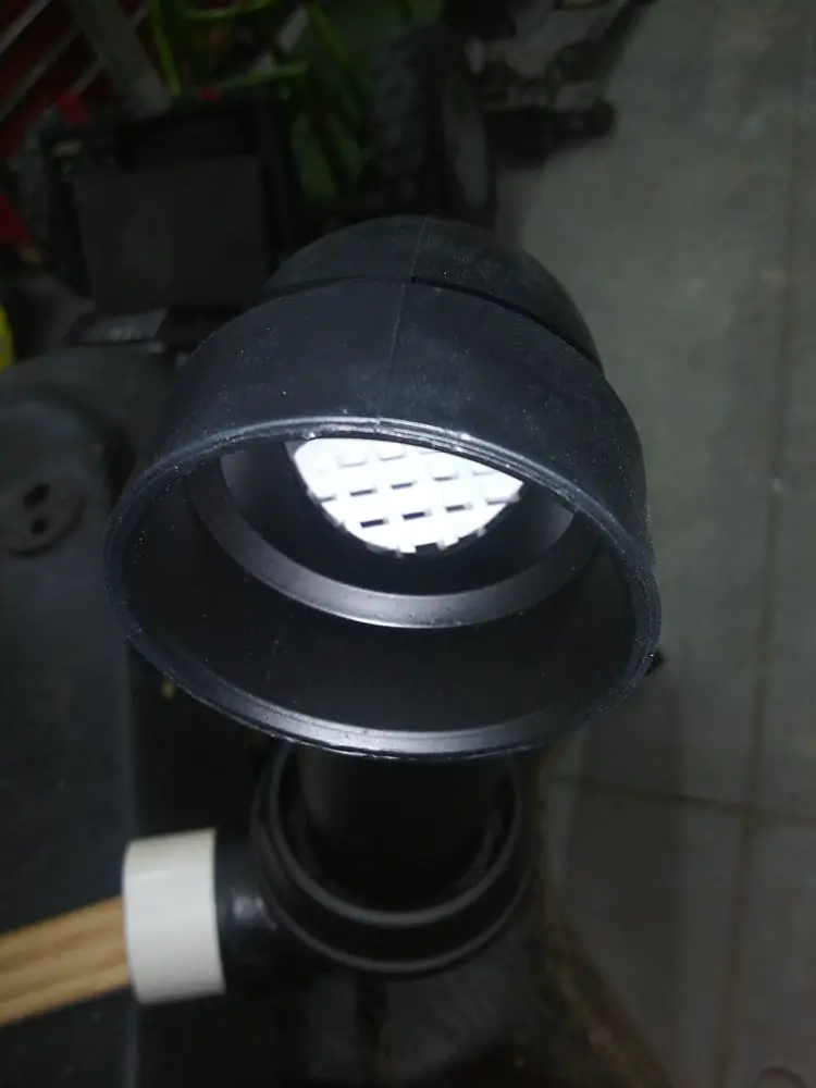

I just litteraly finished it. 2" pvc elbows, about a 2' pc of pvc flex I had laying around the shop and two rubber couplings just so its removable.
20200108 195547
This was test fitting it. Makes it A LOT easier to take off fender and door

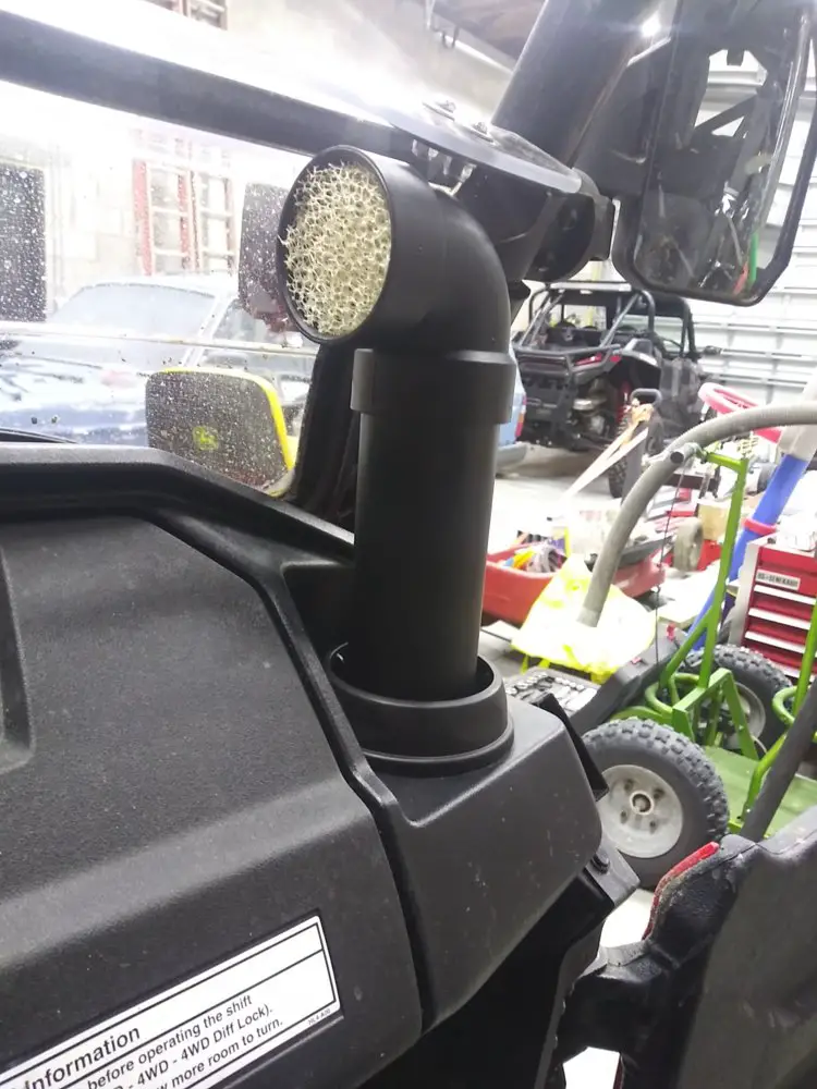

I cut out the bottom of cup holder, 2" coupling fits in there snug so the top wont move around
20200108 195538
it fits perfect under the lip of the windshield
20200109 212322
I put rubber coupling there so I can take the top piece out if need be

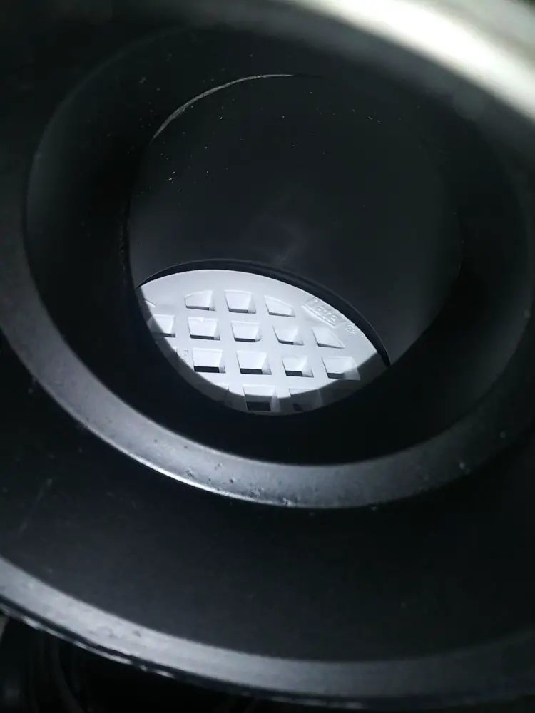

trimmed the original pre filter to fit snug and found this Oakley test cap to put in there when transporting or pressure cleaning it.
