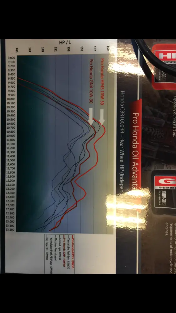

Here's a comparison based off a dyno test.
