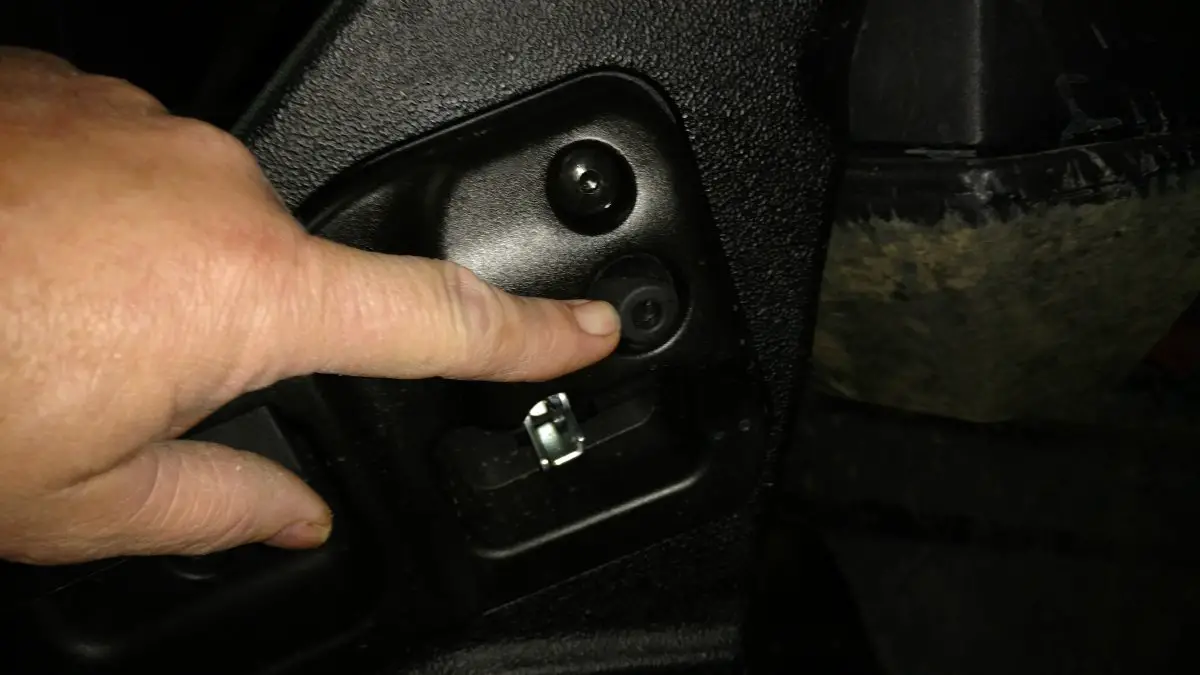

Deltot: 37466 said:
This is stopper for the front. It's on the door itself. Turning it counterclockwise will back it out to eliminate rattles. If you back it out too far the door won't latch properly. It's a double click design so keep that in mind.

I did notice all 4 doors rattled thru rough terrain. What are the simple door stoppers your talking about. Could you post a picture please. Also have you noticed that on the door hinge theirs a metal washer on one side and then a huge gap on the other side. Washer missing?

On my 700-4 I put electrical tape around where the door latch meet the holder thingy. Solved my door rattles.
The rubber stopper he suggested fixed the side to side rattle BUT the door still rattles up and down because of no spacer/washer on the one side. Its weird how honda only put it on one side
I did this tonight on my 1000 on the bed latch and the rear doors. All the rattle appears to be gone finally.
