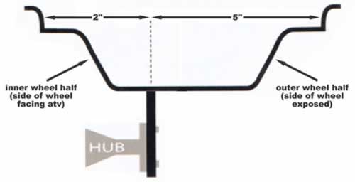

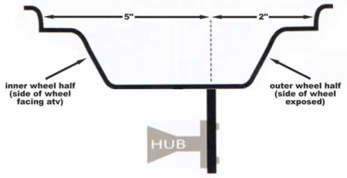

So is the 2+5 mentioned the same as 5+2?

2+5 Offset vs 5+2 Offset
25 offset 52 offset

what's the reason not to use 2x5 and no spacers?
Great question. I do not know the answer other than there are very few wheels for sale that have other than 5 x 2 or 4 x 3 offsets. I speculate that the manufacturers do this to reduce the amount of inventory they must produce and store. You can always add spacers to widen the stance; there is no easy fix if you have to narrow it.
I suppose that you could put 5x2's on the front and 4x3's on the rear of your P500 to even the stance and eliminate the expense of rear spacers but you would lose the ability to rotate the tires.

  1. Talon X LV
"Very Few Wheels"....NOT TRUE
Example: ITP offers 2+5 " in almost every model wheel that they sell. They offer 16 2+5" models or so in steel alone counting Black and Silver colors.
IMHO our members need facts, not opinion, on things like this. Don't ya think?
