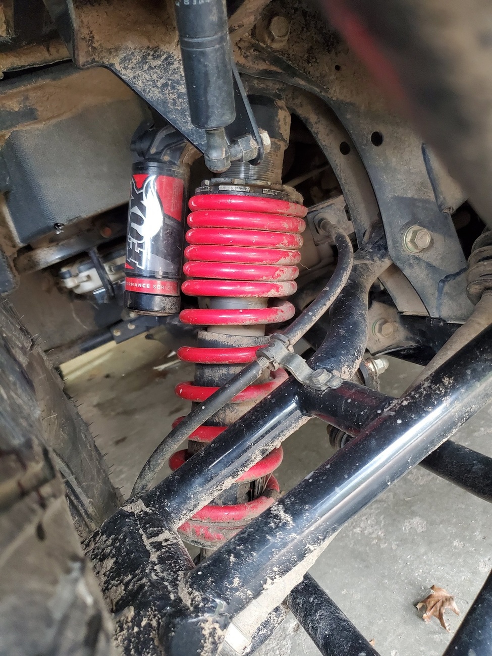

I'm in the same boat. Did just the rear and what a major difference! Got rid of the bucking and was able to use the entire suspension stroke. Haven't seen a need for the front.

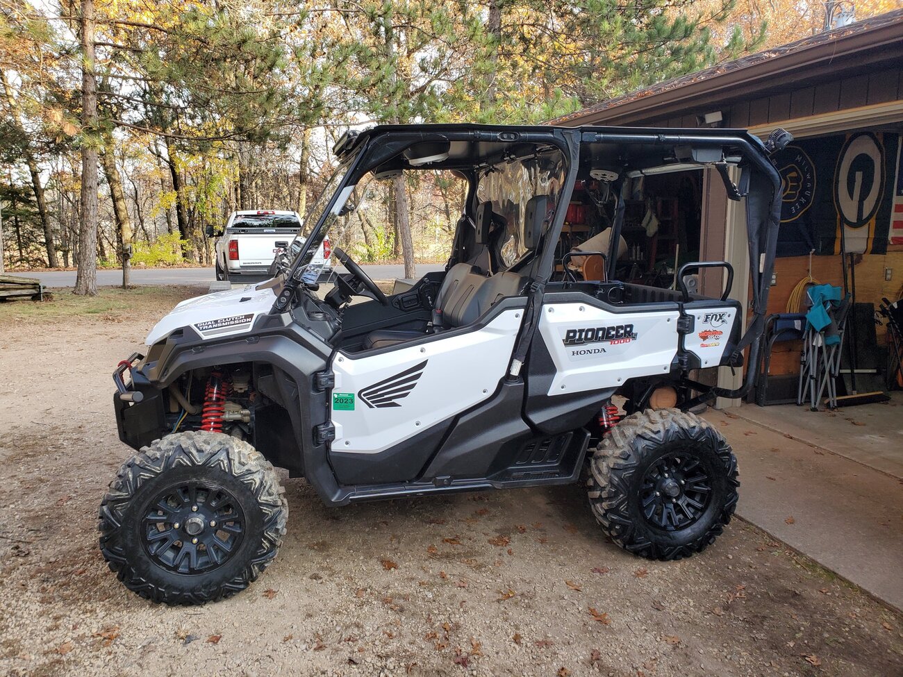

That top picture is what mine look like with the spare mounted. No preload added. New rear spring are now on my list. Thank a bunch.

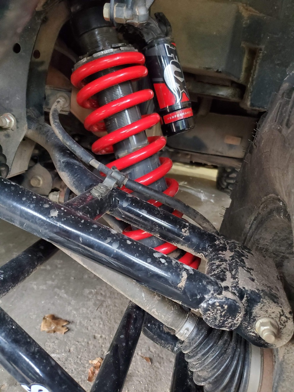

I had adjusted my preload after the first 1000 miles. They had sagged over an inch. The unit is a 2021 and we trail ride often. After another 500 miles the had sagged even worse. On the stock fox springs that is. The collapsed picture is just the weight of the machine.
