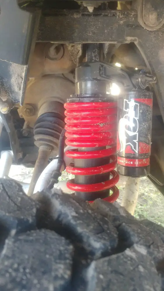

I finally got my front springs on this week. I think 250 lbs might turn out to be a bit light for my taste. So far, I feel like the front end is a bit "thunky" - it seems noisier, like it's under duress all the time, where the progressive springs seemed more comfortable with the terrain.
I turned my fox clickers up to medium (from soft) which helped a little. I'll run them for a while and see what I think. It's hard to really compare between these things. It'd be great if you could switch back and forth immediately to test.
The worst thing about the install is that the shocks were an inch longer than their mounts once reassembled. I had to use my spring compressor to clamp it up some, then I had to hand push the shock against the hydraulics, then put it in place and quickly get the bottom bolt through before the piston pushed it back too long. Major PITA.

Do you have a picture of the spring installed on the shock? How much preload do you have?

Interesting, with the SATV arms there wasn’t any issue bolting them back on, wonder if the shock mount on your arms is a different location then the stock arms which I believe the SATV is the same as stock.

If you can't swing the arm down low enough to put the shock bolt in, you have probably maxed the CV angle or Tie Rod. Might want to look into what's binding. Think the TTC arms have a built in lift by moving the shock mounts. Probably will want limit straps if its bind that limits droop instead of the shock.

Good point. They came out fine from the old TTC arms (I had to put in new TTC arms here) so I was a bit puzzled why they didn't go back in as easily. I don't think there's anything different about these arms.

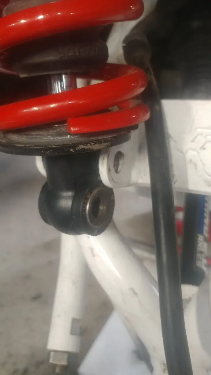

Here is why I immediately became interested in going to single rate springs after installing the QS-3 shocks on my Pioneer 1000-5:
With coil-over shocks, you can adjust your preload. Preloading allows you to dial in your spring to optimize ride quality, and it also allows you to change the ride height of the vehicle.
Prior to installing my QS-3's, my machine had a bracket lift, stock shocks, and forward a-arms. I removed the bracket lift and put in 3" arched and extended a-arms (You can read all about that here.) With the QS-3 shocks, I actually lost ground clearance in the rear compared to the previous setup with my initial preload settings. I did eventually preload them even further to recover some rear clearance (more on that later) but this is the result:
See the top of the shock, how the coils are completely collapsed? That's the entire 185 lb range of my progressive spring, rendered useless. I'm essentially riding on a 350 lb spring that's shorter than it needs to be because it's got 2-3" of solid surface above it.
My rear shocks look almost exactly like this
