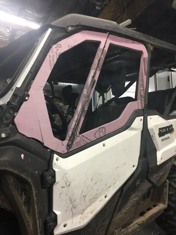

Here's where the First problem of three major lies with building your enclosure in the front. The nose tilts in from 18" back of the ROPS and will require an angle in the middle of the frame. Figuring out a window in an angled piece is a little difficult without recessing halfway into the frame. Thinking two separate windows will work for my application. May actually look pretty sick. Some vision will have to be sacrificed but winter months aren't as important to us because the tight trails get eliminated to a degree

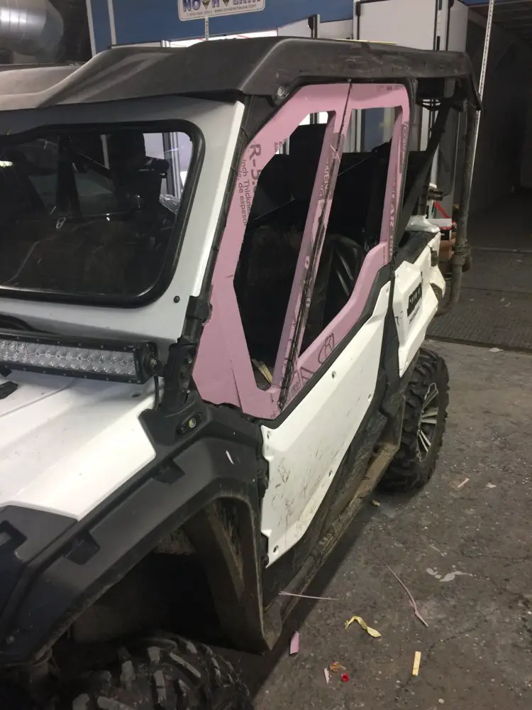

Ok first problem done. Upper door is now one piece and the right basic shape. The upper is taped but nothing but no wedges anymore. Looking good.

Very true! Next door will be easy. Back doors will be tough. Rear panel easy!

For everyone wondering how this is going to work here's a little preview. It's totally sitting on its own. Gap is 3/8 all the way buy it'll gain 1/8 on upcoming step. So I'm placing 1/4 weather strip all the way when finished. Image
