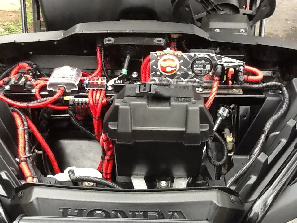

what is the main purpose of running dual battery's and does the Honda assy. cable give power to lights or does that also have to run back to the battery.
You can run 4 accessories off of the accessory sub-harness, no need to go back to the battery. The only concern will be wattage draw, you can't exceed whatever the Honda OEM circuit is designed to handle. Without knowing what the circuit is rated at, you'll probably be safe assuming they are 5 amp circuits. Two lights like the common 18 watt Ebay sets won't be a problem on one of the wire sets. Light bar? I'll defer.

For my purposes, the dual battery is so that when we stop for breaks and lunch, or just setting around the fire at night, we have music, and I don't have to worry about that little 16 AH OEM battery falling off and needing a jump. Check out the dual battery thread if your considering one. The Honda assembly harness provides you four keyed power sources that are pulling from the OEM battery.

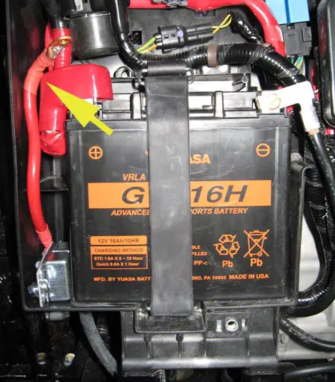

I'm probably going over the top on this, but...............

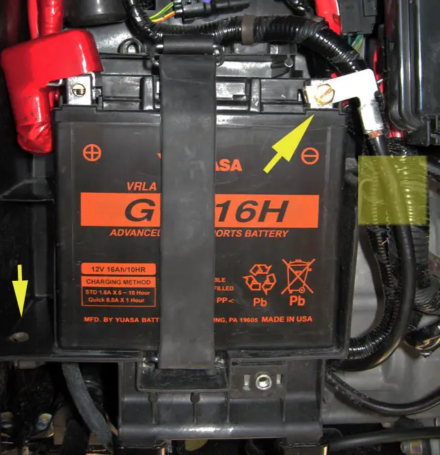

This is where I left off last weekend. Cutting the cover to free up the vertical wire channel, drilling the wire access hole and grinding off the corner of the negative terminal connector so I could tilt it up a little. The negative wire now clears the lip of the box and runs down the vertical shaft stress free.

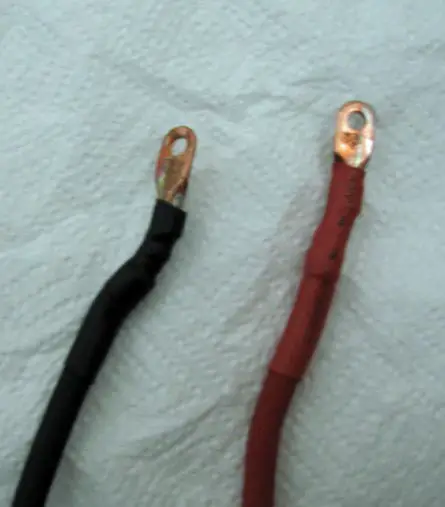

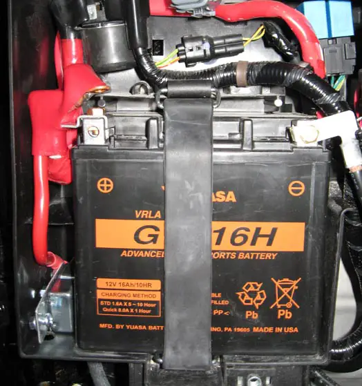

Today I cut the Short lead supplied by Tera, soldered on a new copper connector and then sealed it with a couple of layers of shrink wrap.
It even fits in the OEM terminal cover.
I bought two ten foot runs of solid copper stranded #4 so that I could relax and run to the front any way I wanted. Soldered copper terminal connectors and sealed them with shrink wrap.I should be able to close the box for the last time next weekend.
