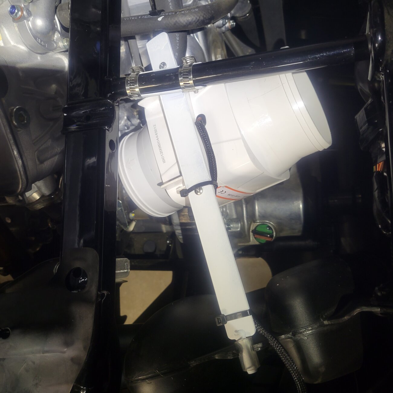

As Smitty335 says, no big holes required. Many consider a 4" bilge blower, directed toward the engine header pipes, does a good job. That's what I installed below, this winter . . . so it hasn't been tested in combat yet.
20211210 212543
Many screw or bolt a metal strap to the seat braces, then bolt the blower to that. I welded up the bracket to mount with two hose clamps, so it removes without fuss for easy access.
It was cold in the shop, so paint's drying in the dining room - - wife is used to this aberrant behavior after 52 years.

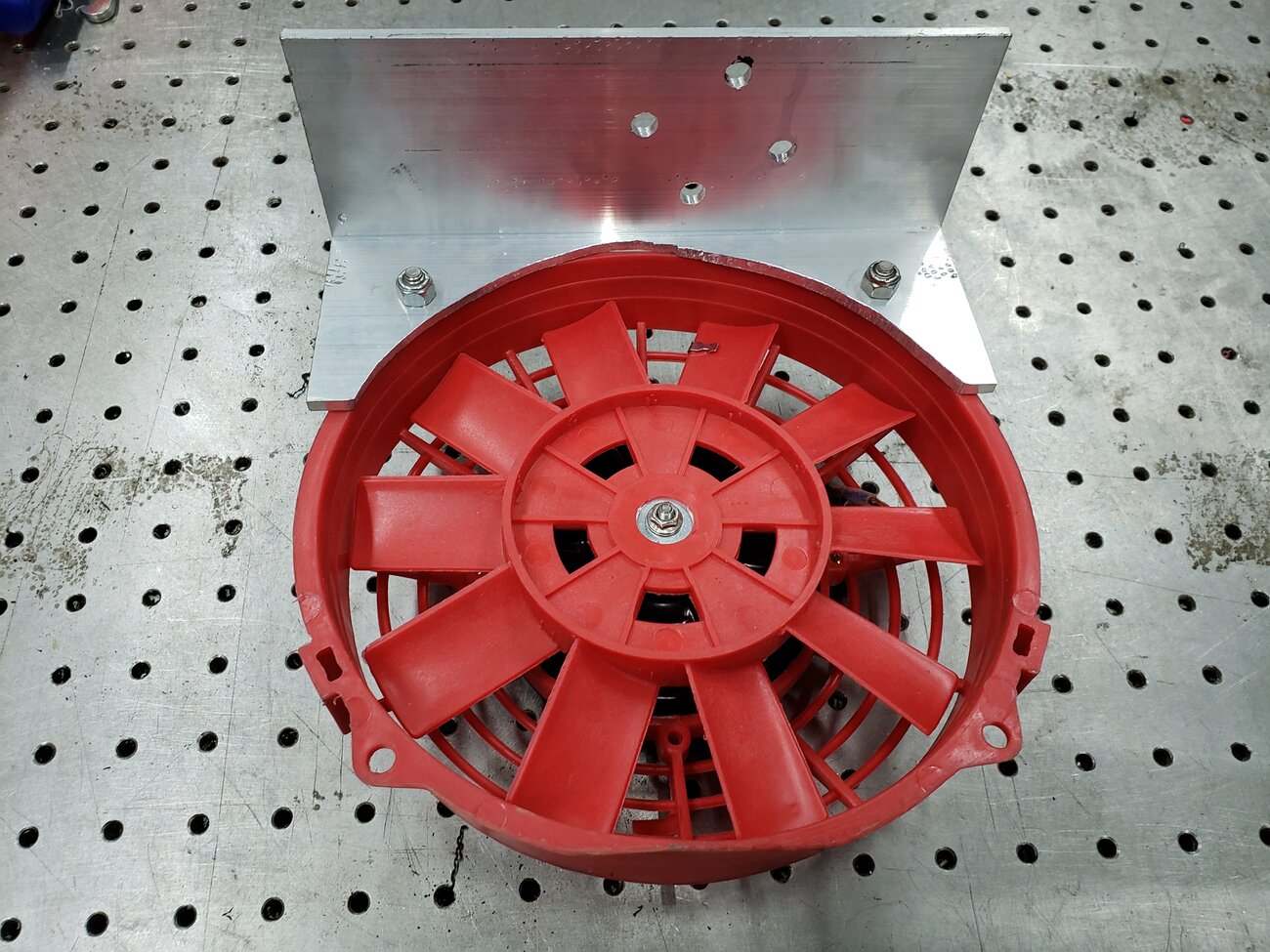

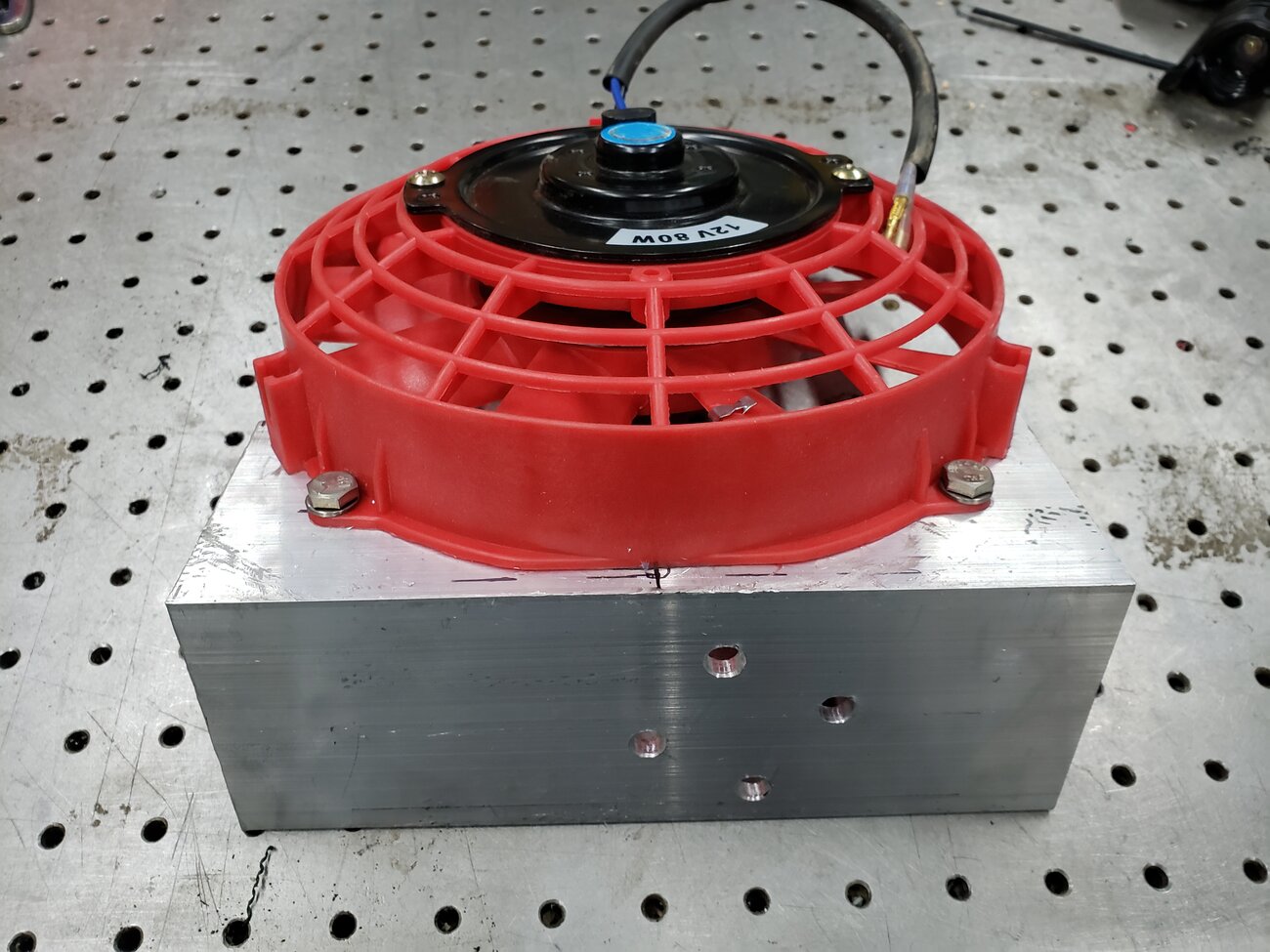

This is what I did in my P1000-3. It is an 8” fan and about 1100 cfm.

I also installed the DEI heat shield kit, which helped a lot.
Wow, that's pretty crafty. How long have you been running that setup? I would be worried that the fan might melt.
If you could get it pull cool air in with ducting similar to the bilge pump setup it would probably work really and it would be hidden away.

Its been in place for several months in my machine. I got the idea from other members in the forum, and they have been using this setup for a much longer time than I have. The area under the seat tends to build up heat due lack of airflow and the location of the engine and exhaust piping. I am pleased with the result so far. I decided to go this route vs the bilge fan mainly for increased airflow.
