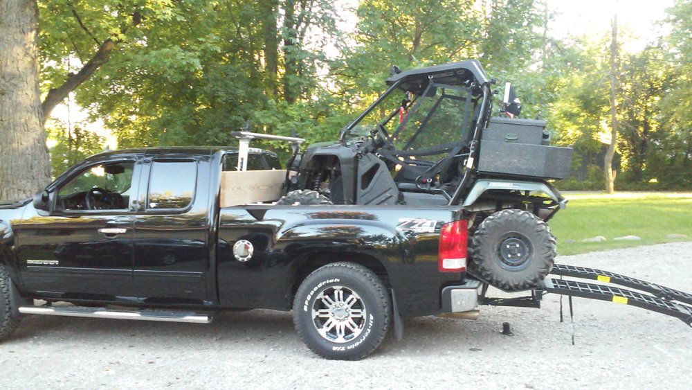

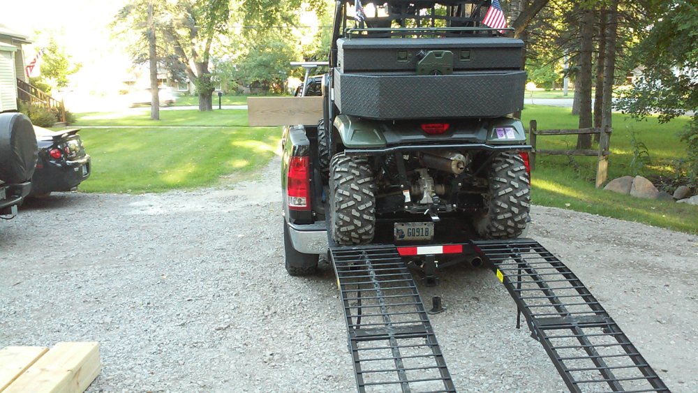

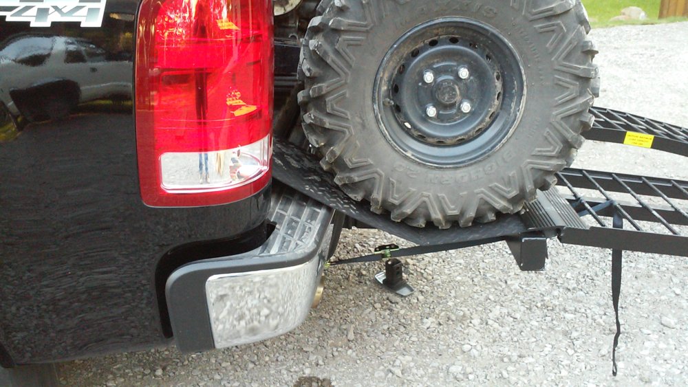

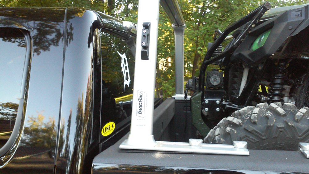

I think it's 4500 lbs. My little 18'er only weighs 3300 dry. Won't be able to load firewood in the back now which kinda sucks and was looking at where I could store ramps. Sits low in the ass so I can't just slide them under. I'll come up with something...but I like the low COG.

Loaded Front Loaded Rear
Had a couple more.

I'm sure you stated somewhere but I don't recall, what was the reason you don't just haul it with the tailgate down and the wheels on it?
To pull the camping trailer behind it. Could have went with a simple hitch extension but I think this rig is slightly shorter.
I thought the front tires would sit up as high as the wheel wells and liked the idea of dropping some weight down.
Now it sits even lower. Don't have the corners of the tailgate sticking out either.
