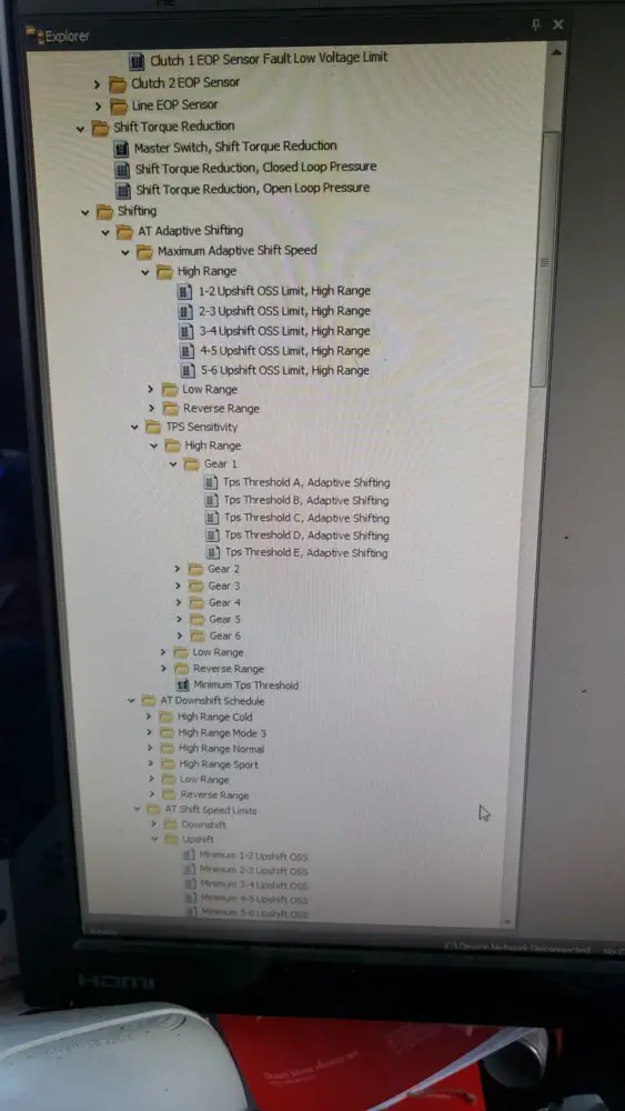

Can you check? Try making a duplicate of your read and changing the file extension to .bin. If the .bin file will still work in PV3 editor program or WinOLS then it's not encrypted.
No luck. Can't see the definition file after changing the extension on the tune file.

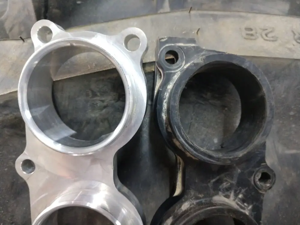

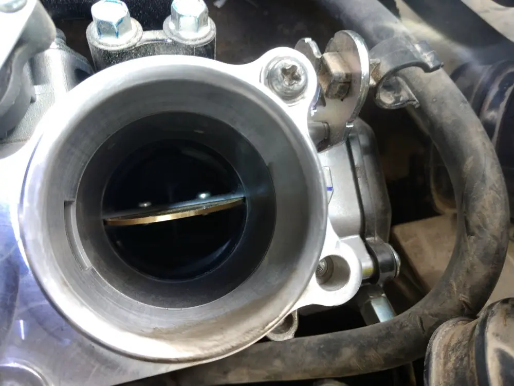

I messaged the eBay seller and asked and he said it won’t work for Pioneer but doesn’t know why. I have some eBay bucks begging to be used but I will wait for you to confirm it fits. Thanks
It fits perfectly
The black adapter in the picture is a bored out A/F adapter that i would NOT recommend to use, that I used anyway.

The throttle body is a plug and play mod
But you need to bore out stock throttle body to air tube adapter or buy a Talon adapter, or a Honda Talon Aluminium Throttle Body Adapter | eBay

For those wondering the bin file is perfectly usable and not encrypted. I am not sure what tables WinOLS will define for you, but if someone is working on it I would be happy to share info to work together. I have quite a few tables already defined with addresses. Also, if someone has a pioneer file in bin format I would love to see the data and driver differences!
