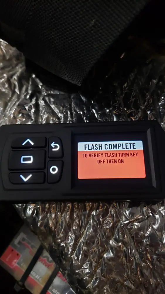

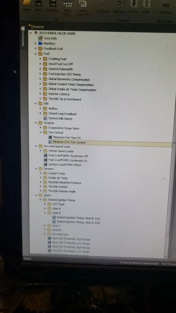

I used the Power Vision 3 to data log and flash my Talon ECU in my pioneer.
Resized 20190920 213831 Resized 20190919 210159

Sure wish they would have had that out months ago....do you know if it reads in .bin or .hex format? Does it read in an encrypted format?
I didn't look to see. I'm sure it's encrypted though.
Z
Zmorris83
Can you check? Try making a duplicate of your read and changing the file extension to .bin. If the .bin file will still work in PV3 editor program or WinOLS then it's not encrypted.
