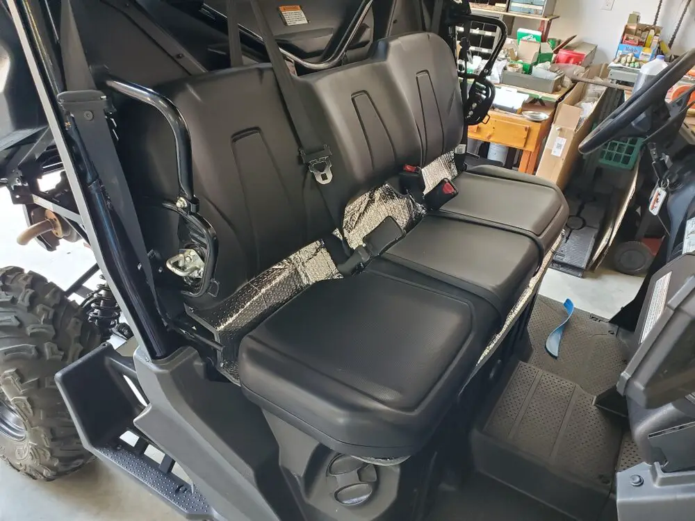

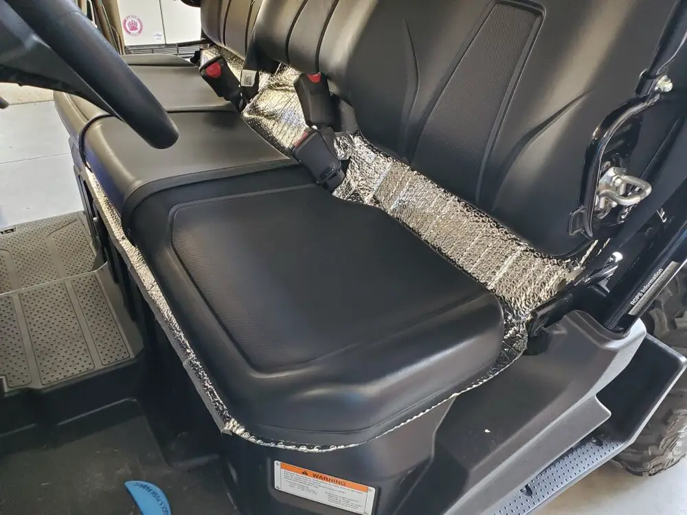

i almost asked this same question yesterday. (for same purpose) looked online a while, without luck. Just gave it another closer look and located the 10mm bolts. I removed just the outside bolt, and loosened the center three. I didnt want to struggle reattaching the darn thing without another hand to help. Worked fine for me to get what i needed fed up behind back of seat. And i didnt have to take off my hard back window or lower plastics.

View attachment 284956 View attachment 284957
Actually, it's not all that tough to put back in single handed, even for a septuagenarian (that's age 70 to 79). Just start one end bolt then lift the other end and start one there - middle three are then started. Piece of cake.
