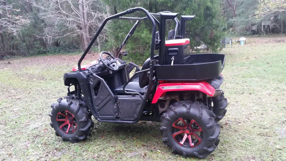

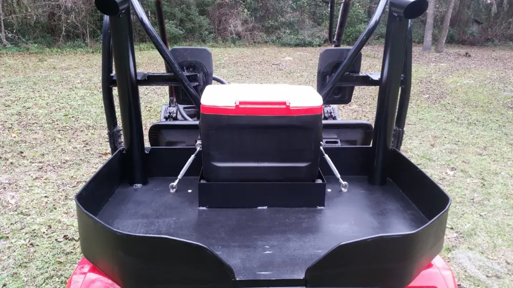

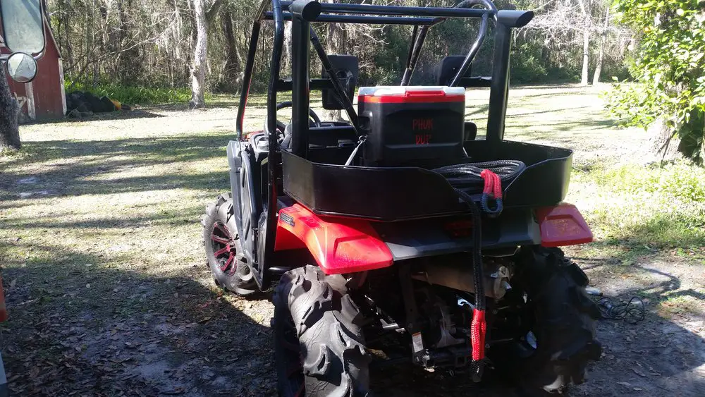

Update on aluminum bed build. Its done except for the plumbing from the airbox to the drivers side stack, ive still got the 2.5" shop vac hose from the airbox to the bottom of the stack, but i'll be replacing that with black pvc and elbows and stuff when i get a chance. I'll also be attenpting to run the exhaust to the passenger stack pretty soon. I'll post pics when i do. It can be rode now though how it is. It turned out pretty good i guess. Most importantly, i can reach the adult beverages from the drivers seat when we are trail riding or muddin. Lol Anyway, heres a few pics. I hope yall like!

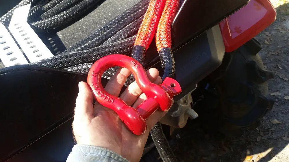

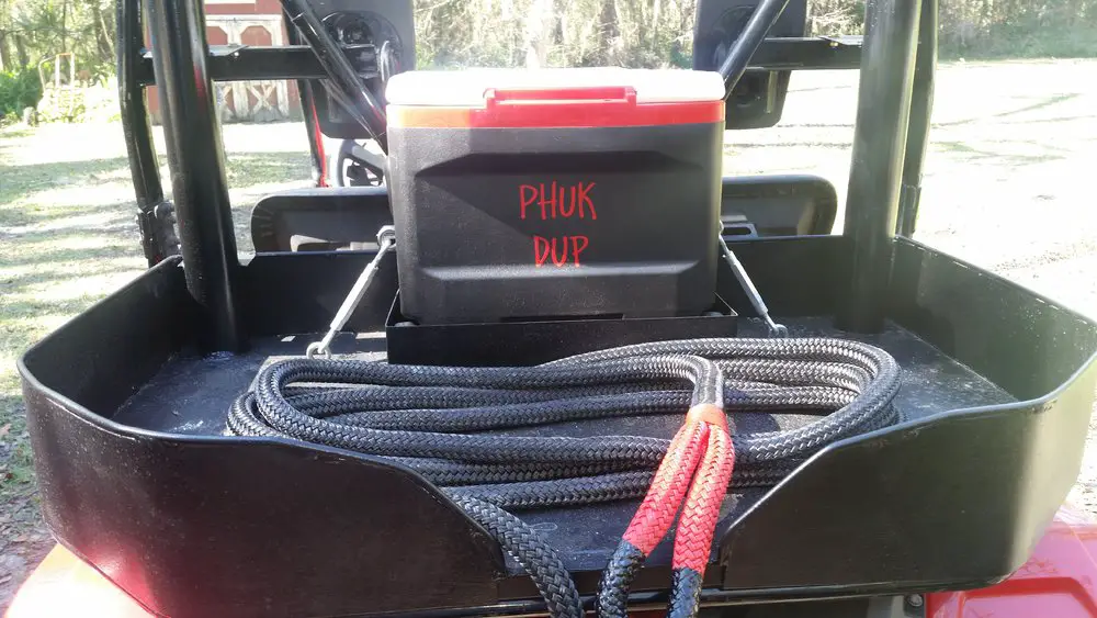

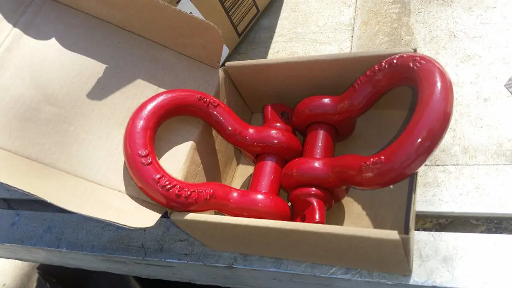

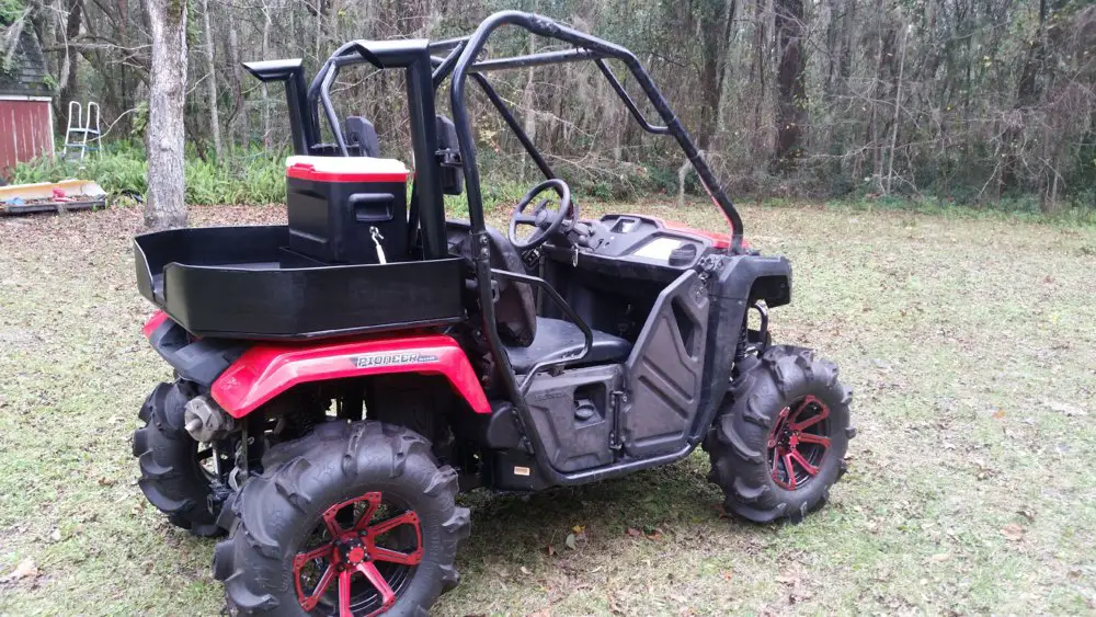

Well its been a while since i updated this. I had a sticker made for the back of my cooler a few days ago. I got out here on my day off and put the sticker on my cooler and actually started taking measurments and cutting pipe to connect my muffler to the exhaust stack when the ups truck pulled up in the yard. He had a kinetic snatch rope that i ordered from amazon 2 days ago. I wasnt expecting it for another week! Thats perfect because we're going camping at hogwaller in palatka, fl. next weekend, the 17th, 18th, and 19th of feb. Yall know i ordered it to match! Red and black, lol! Its 7/8" × 30' and rated at 28,600 lbs. I think it should do. Hehe. Sooooo, i think i might lay off on the muffler stack build and start on the snatch rope holder thingy that goes in the bed build! Lol Heres a few pics for yall.

Thanks monte! I used a small can of rustoleum from the auto parts store for like $24.00 and i got the application kit for like $12.00 that comes with the paint brush, roller, and pan. Washed everything and etched it with white vinegar and sprayed it with etching primer. Did the bed in the bed liner, and the stacks with high heat bbq grill gloss black. On another note: the mail lady just dropped off another thing ive been waiting on, red shackles! Lol

You're turning that thing into a beast...nice job BC!
P.S. Sorry if I don't remember but have you given that machine a name yet?
Just holler if you need ideas.

Oh, I saw your earlier post with that product. I should have been more specific, I thought maybe you had used some sort of rubber matting for the floor after you had used the bed liner paint on the whole box. Hopefully those shackles are powder coated. So on the snorkel, are you talking about using PVC and painting it black, or using ABS?

Monte i just used 2" white pvc water pipe and a couple of 2" 90° elbows. I cut a short piece of 2" pipe about 3 or 4 inches long and stuffed that in the rubber elbow that comes stock on the top of the airbox. Put a 90 on it right outside the box and ran a short piece of pipe forward, then put the other 90 on and ran another piece of pipe out of that 90 straight to the bottom of the intake stack. That piece of pipe went into that red high heat silicon 90 that i got from ebay. That 90 is 3" on one outlet for the stack, and 2.5" on the other end. The outside diameter of 2" pvc is almost 2.5" so it worked out good when i put the hose clamp around the 2.5" side and tightened it up. I did have to buy a heat gun and i heated up a small part of the drivers rear fender and pushed it in a little so the piece of pipe can have a straight shot at coming into the red 90. You cant see it from the outside, you would have to look under the wheel well to see it, and about 5 minutes after i start riding it there is mud in the fender wells anyway so it will never be seen lol. I was wanting to go with black pvc but couldnt find any locally, but its all under the bed and cant be seen anyway so im not worried. It runs better now also that i did away with the shop vac hose and completed the intake to the stack. It fires right up faster it seems. It seemed like with the shop vac hose it cranked over a second or 2 longer before it started.
View attachment 32641 View attachment 32642
I don't care who you are....that cooler decal is funny!!!

Monte, you actually just taught me something. I have always called the black ABS pipe, black PVC lol. Yes you are correct, the pipe used under mobile homes for drainage. Thats what i was looking for, and just used 2" white pvc instead, with the intentions of painting it black. However, when it was all said and done, you cant see it anyway, so im leaving it white. Also, it was the tight 2" 90° bends, not the swoops.

Well i got a few updates. I got the snatch rope holder thingy built and installed in the bed. Also, i made some progress on the pipework that goes to the exhaust stack. I welded a disc in the bottom of the exhaust stack and made a hole in it big enough for the aluminum pipe to fit into. The aluminum tubing is from some old street light arms i got out of the dumpster at work lol. I swear, i get so much cool stuff from the metal dumpsters at work. Lol I cut a few arms up and used the curved parts out of them to get the bends i needed to get it headed towards the back of the sxs. Anyway, blah, blah, blah, heres some pics.
