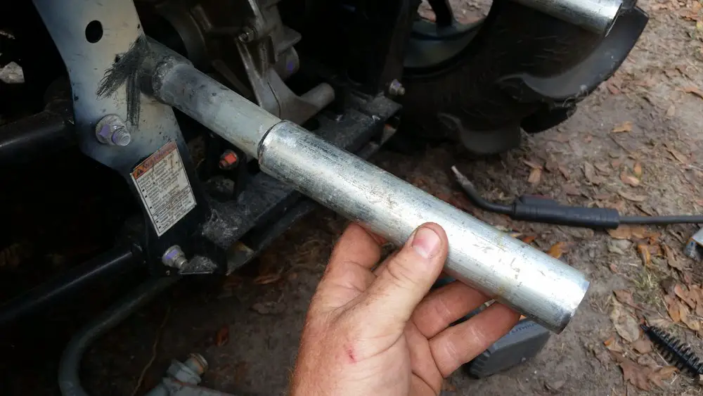

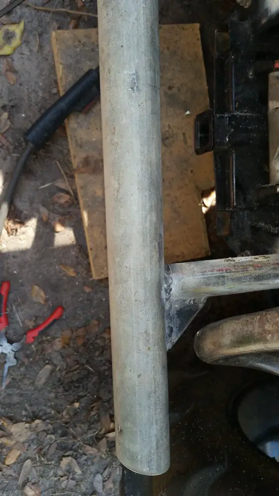

I got a little update. Ive almost got the exhaust complete. One of the things i was worried about was how i was gonna join the steel pipe coming from the muffler to the aluminum pipe coming from the stack. Well i found one of my cheater pipes that i slip over wrenches was almost big enough on the inside the slide the aluminum pipe into. I took the flap wheel to the aluminum pipe and the burr bit to the inside of the piece of the cheater pipe that i cut off, and pressed the aluminum into the steel coupling, and i mean PRESSED it in! That motha is Tight! It wont leak water in gauranteed. After i pressed the pipe coupling on i welded a flat plate closing up the coupling and then i drilled out the center of the plate to the same size as another pipe a little smaller. I cut this pipe 4" long and slipped it inside the hole that i drilled and welded it in. I made a bracket that bolts to the 2 passenger side rear rack bolts and is welded to the piece of pipe. Also the curved aluminum pipe is welded into the bottom of the stack now. I was kinda worried about maybe something getting slung up by the tire and hitting the union coupling and knocking it loose so i welded a few aluminum tabs on the aluminum pipe right up against the steel coupling, then i welded a few steel tabs off of the steel coupling and they meet up with the aluminum tabs. I will be able to drill a hole through both sets of tabs and put screws through them to keep the union together. I havent welded the curved steel pipe yet that comes out of the mufflerand curves around and slips inside the 4" long piece of pipe that has the bracket welded to it. I put the curved pipe in place though and started it up. I was able to rev it long enough to watch the exhaust stack blow dust and dirt out the top! It was cool! It seemed to run fine and not make a difference on how it runs. I would say the stack maybe made it have a little throatier sound. I will finish weld it tomorrow and clean it up then paint it high heat gloss black. I am gonna have to build a rear bumper to protect the bend where it comes out of the muffler. I actually thought of drilling a hole in the side of the muffler the same size as the hole in the back of the muffler and just welding a cap over the back of the muffler and have the new exhaust exit come out the side over by the passenger side rear a-arm. Then just route the exhaust pipe from that hole to the stack. I dont know the internal workings of a muffler though, so i dont know if that would work or not. Normally i wouldnt be scared to just say f-it and drill a big hole there, but im kinda in a time crunch. We're camping and riding next weekend at hogwaller. Anyway, i just realized this is getting really long lol. Sorry yall. Lol Heres some pics. I know thats what i like to see, pics.

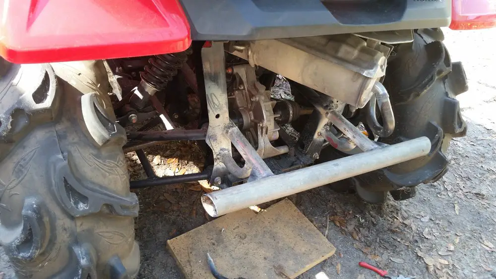

Ok a little update. The exhaust is fully welded now. There is no apparent change in the way it runs. It doesnt seem to overheat or have a lack of power. It sounds mean now too! It has a nice little rumble to it! I noticed it blows condensation out of the stack, and apparently one of my aluminum welds where the aluminum pipe is welded in the bottom of the stack is seeping the condensation out through the welded. That got me to thinking. Maybe i should drill and tap the bottom of the stack right next to where the pipe is welded in and have a little brass petcock or something to drain condesation or something. The aluminum pipe goes up in the stack probably over an inch, so condensation will collect between it and the wall of the 3 inch stack. I think im gonna clean the pipes up for now and let it cools off. I think im gonna try to build a bumper for it to protect it while its cooling and then when its cooled off paint it all with the high heat paint. Ok heres a few pics before clean up and paint.

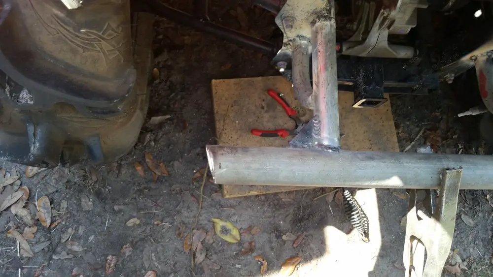

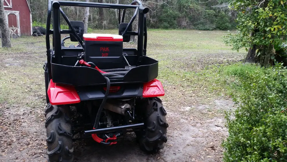

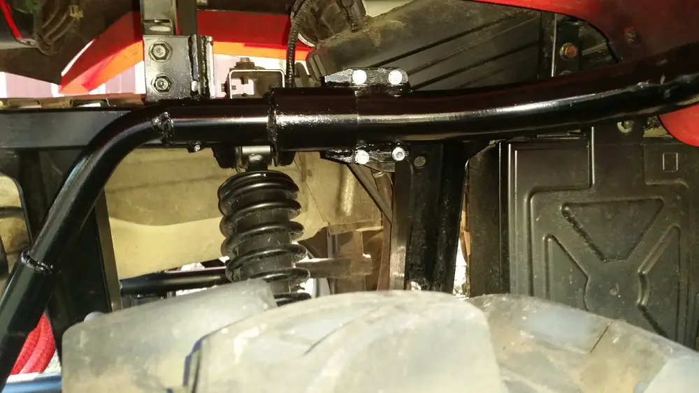

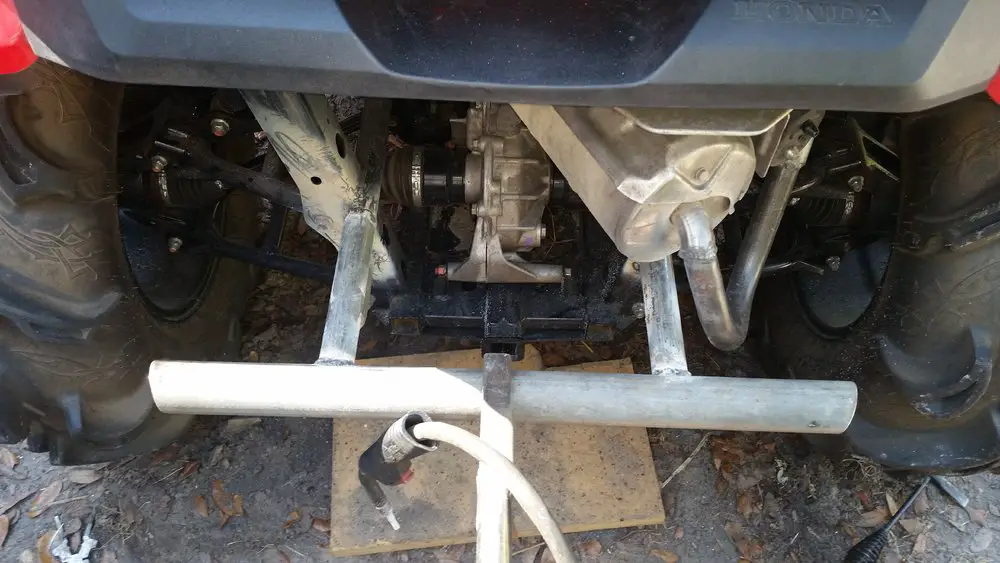

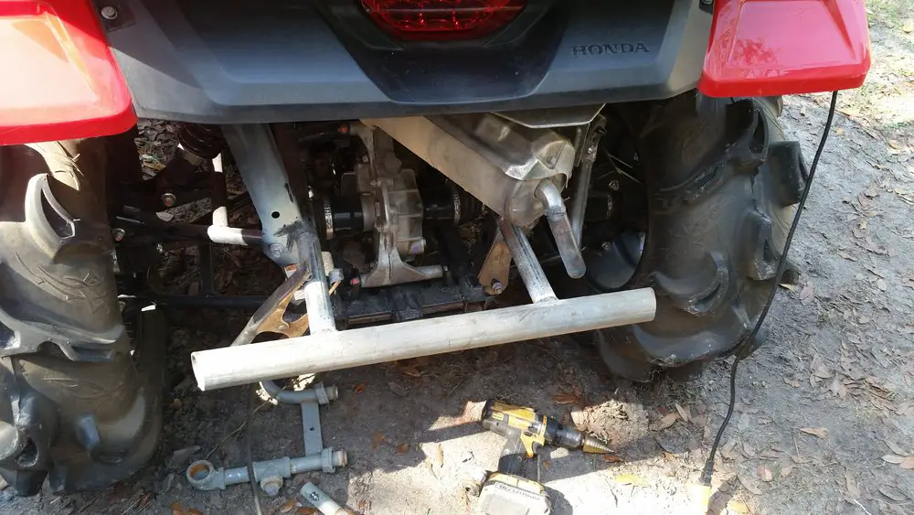

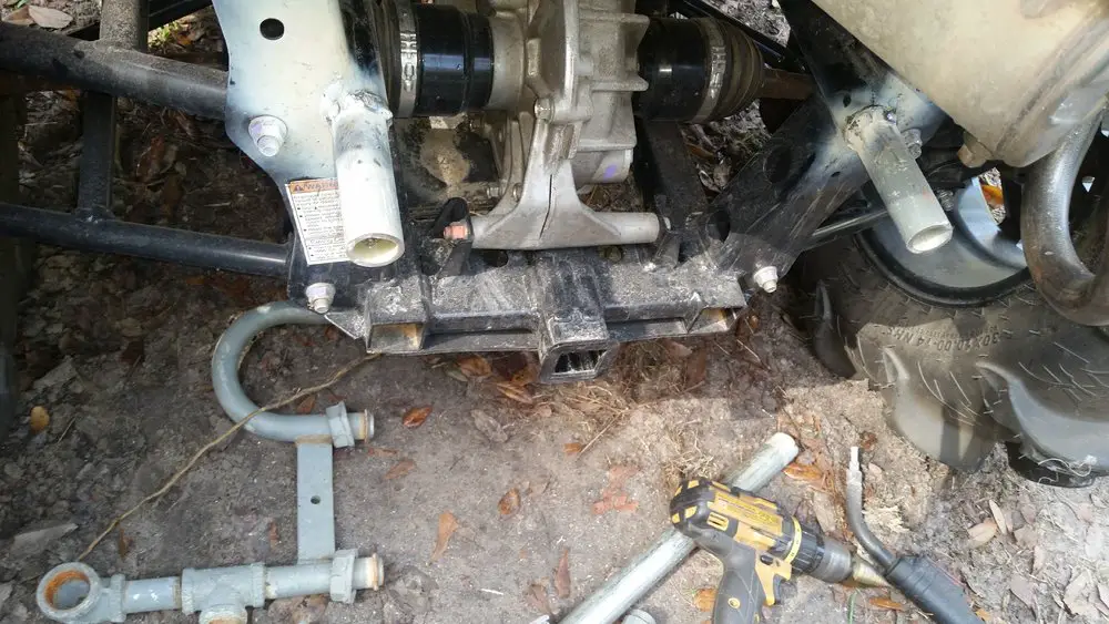

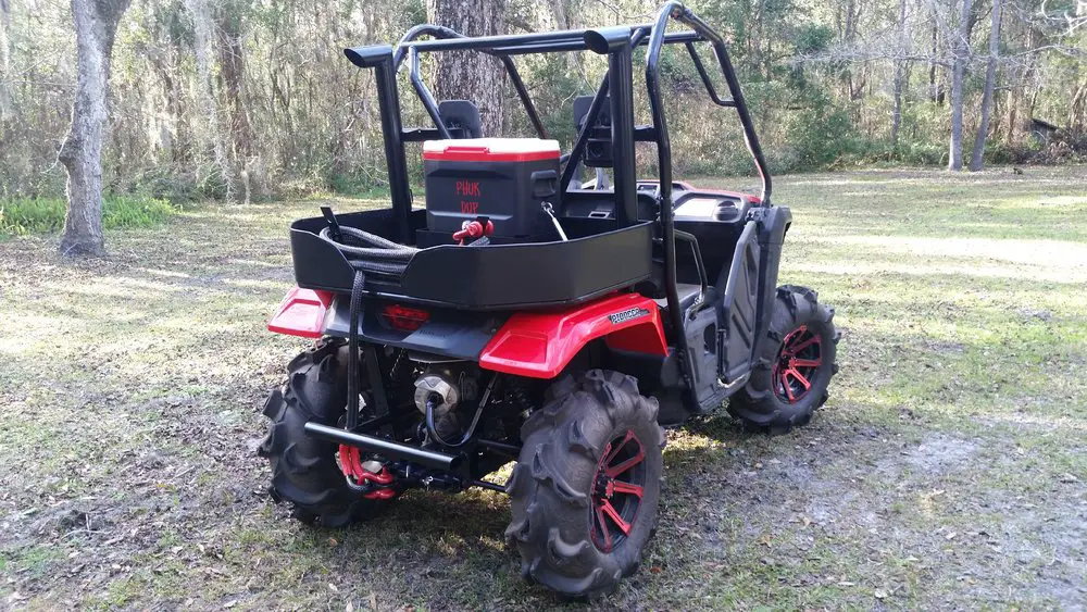

Got the exhaust finished ant painted. Even built a rear bumper real quick today to kinda protect it. The bumper isnt finished. I will be capping off the ends and adding more bracing, possibly a 2nd tube above the first. We'll see. The exhaust is cleaned and painted with high heat bbq gloss black. It runs good and doesnt overheat. I rode it a good bit today around the dirtroad. No problems. Am i the first person to do this?! I have looked high and low on the internet and i cant find a utv with an exhaust stack. I can find plenty of 4 wheelers with them though coming up behind the rear rack. Whenever i make additions to the bumper i guess ill just add it to this thread instead of starting a bumper thread. Heres some pics
20170212 113324 20170212 114001 20170212 121336 20170212 130955 20170212 132959 20170212 133923 20170212 134018 20170212 151258 20170212 161448 20170212 160404

Don't want to be rude but whats the purpose of routing your exhaust like that..
To keep from taking water in. It's not a problem if you're moving but if you stop or stall engine with exhaust under water it'll suck it into the engine. They had a snorkel type HMF available when I bought mine but I don't do much deep water riding so didn't opt for it.

Oh ok ....The highest water crossing or mud hole i go through is normally no higher then the my 25'' tires,but i may add a snorkle later on..
