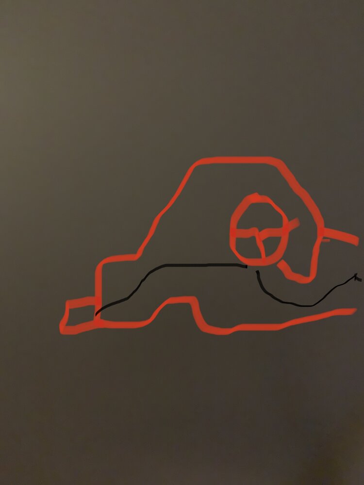

I am installing a Badland 3500 on my P500. The winch mounting is simple, the wiring is not complex, however I am trying to determine the best routing for the power and ground from the winch relay to the battery terminals. I have the winch relay under the hood and have run the power to the battery along the inside of the right side frame rail, with the aid of extension cables because the ones that came with the winch were to short. Is that what others are doing?

I've found the easiest route for all the electrical I've installed that runs front to back, drop the skids and open up the plastics under the seat. Fish down the firewall and route with other cables down the passenger side frame rail and zip tie accordingly. Having access under the seat plastics makes for less under the machine work. Dress in loom if necessary, especially audio stuff.

Yep, did same thing as Trigger except I did not remove all the under-seat plastics and had to wiggle and twist different ways to fish it all through. But same routing and my KFI came with more than long enough cables.
