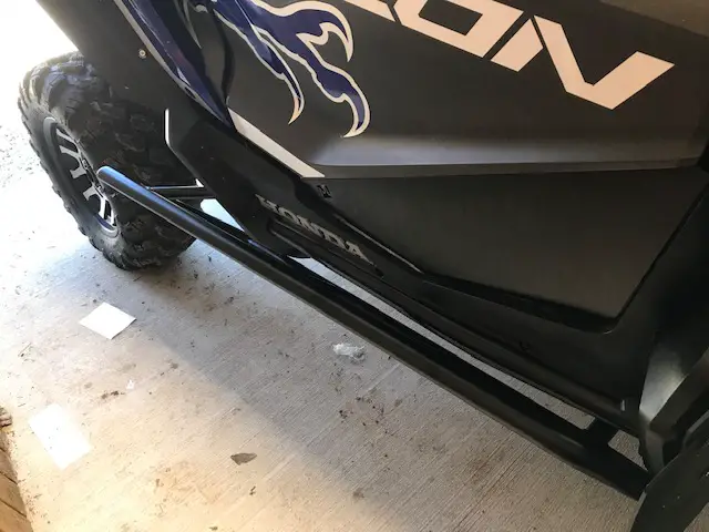

Added the AED Offroad Side Bars/Tree kickers over the weekend. They mount to the holes Honda provides. What I really like about them is they stick out past the back of the machine to deflect you away from trees. Most of the other side bars out there seem to wrap around offering really not "blocking" for the rear. These are made out of .120 min tube, and they are heavy. It took longer to take the rocker pannels off and cut out the slots than it did to install the side bars!
I am excited to get my AED tree kickers too! I am picking them up on my way to Royal Blue in March!) Your build is looking real nice!!!
Cool, yea you will need them there on the TWRA trails. We went there last March and rode ATV's. Really rutted out, but they had bulldozers in there clearing up the trails. You may already know this, but make sure you take your rocker panels on the bottom off and cut out the access ports for the side bars, and put them back on. That takes a lot of time. Not that it's hard, but there are a lot of bolts and push pins. If you have fender flares, like RockBlox, you will have to remove the bottom pieces.
Awesome thanks for tip! I will definitely get that done before I take off for Tennessee since I will be installing them at the campsite! Royal Blue will be this year's season pass. Last year we got one to Brimstone! My sons and I get a season pass to a different place each year and then go there all that year!!

No problem. Jasond did the same thing you are doing, picking them up and putting them on at your destination. He is the one that told me about taking the rockers off first and getting the holes cut out. Lots of good folks on this site sharing information. That is what it is all about.
I get a season pass to both places every year. So many of those trails cross paths on the west side I never really know if I'm on Brimstone or TWRA. Obviously on the east side or Sunquist unit, they are all TWRA. We take a few short notice trips down there, so it's just easier to have a year long pass. I'm only 4.5 hours away from there, and my buddies who live in Cincinnati are only 3.5 hours. So its a quick hop for us.

Yep that's exactly what I did. David Valentine (AED owner) was very accommodating and met me on time exactly where he said he would so that was much appreciated.
Like @PhilCod mentioned, you'll do yourself a huge favor by getting the plastics prepped and ready where all you'll need to do is bolt the kickers on. It definitely helps to have a buddy hold them in position since they're heavy (in a good way).

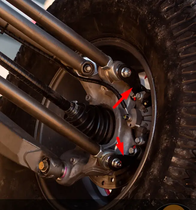

I recently purchased the Bosman Designs double shear brackets for my R, thinking those would be the strongest design, but I didn't take into consideration the spacers used with the L&W radius arms means the Bosman brackets wont work. The Bosman brackets attach from the caliper mount to the radius arm, the McNasty bracket only goes between the radius arms. Trying to better educate myself on which bracket to choose, wouldn't a bracket that ties into the brake caliper mount be stronger than one that ties the 2 radius arms together?
I think you'd be fine without the shear stopper. IDK, see if you can find out what Honda did for the KOH machines. I bet they don't have "shear stoppers" on them.
You're probably right, I'm likely buying peace of mind for myself. I wound up getting the All thingz UTV shear stoppers, they work with the L&W radius rods.

Yes, they do have Shear Brackets. Hard to tell what brand but they look a lot like the Bosman Designs...
Im curious about that axle... wrapped in electrical tape? Not using an OEM boot clamp either which might be from a repair?
I think the axle wrap is a racing thing to help prevent rocks and debris from constantly hitting the axle shaft directly to reduce the risk of micro-fractures and nicks that could cause axle failure/breakage during a race.
Not sure what the strategy is with the hose clamp for a boot clamp, but I’m guessing it’s to make for a speedier fix if they needed to remove/replace it.
Correct, the axles are wrapped to protect them from nicks and chips that can lead to hairline cracks that can eventually lead to failure.
Maybe the hose clamp was an "on the spot" fix and that was all they had because you can't remove those clamps on a Talon without destroying them (been there, done that).
There are several pics showing the team constantly tweaking the suspension and even this one the front axles out but I can't think of any reason to disassemble the outer CV unless they replaced an axle shaft...
I stand corrected! I have seen this version of shear stoppers on the Facebook forums. It is the way I would go if I did get them...which I probably won't lol.
