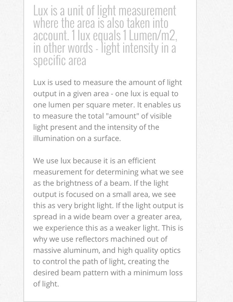

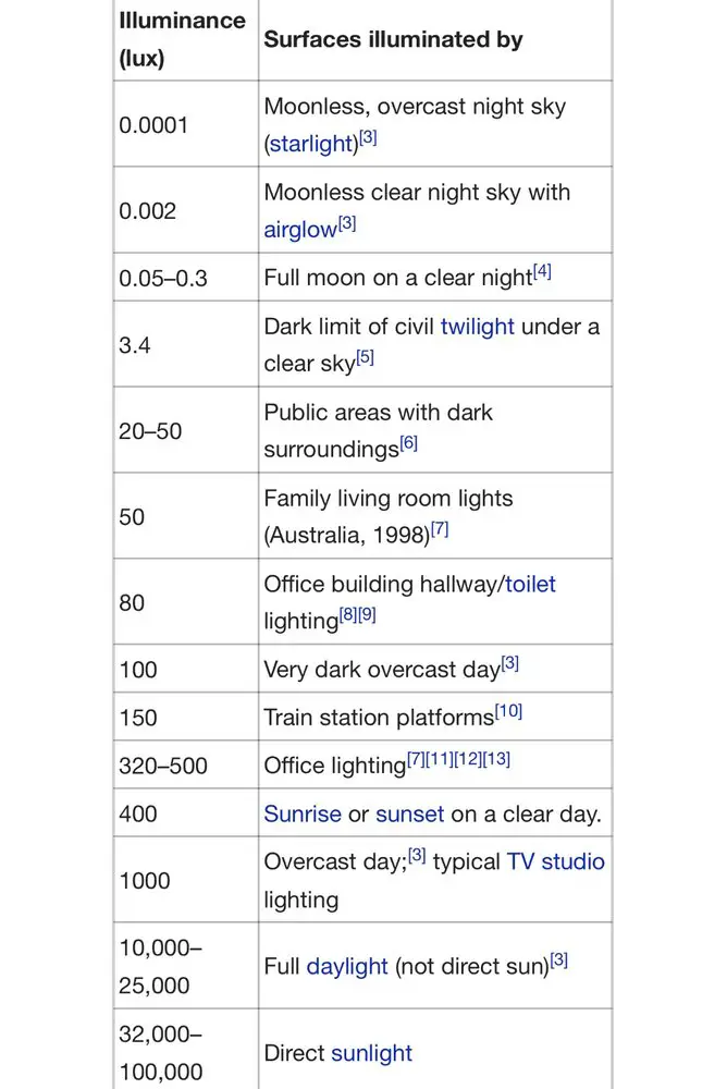

Lumens and watts is a sales gimmick. You want to know the LUX output.
Lux - Wikipedia
off road led light bars information | Super Bright LEDs
Not real true lumens does measure light output, but it doesn’t tell you how focused it is.
I have a 3900lumen flashlight that puts out a clean even wall of light and will light up my backyard pretty well, Lux is about 19000, carries @300m.
I have the same flashlight body with a different drop in that is 1100 lumens but is 56000 lux and it has a beam good out to about 1000m.
Lux - Wikipedia
They are used as a sales gimmick. Just like salesman in all different industries try to twist numbers or data into their favor. For our Hondas, I’m just buying the cheap stuff on Amazon because I know I’m gonna break it anyway. Maybe if I was desert riding out west somewhere I would probably want a high-end light bar. In the forest environment that I typically ride in these cheap light bars are fantastic.
But I will tell you that LUX measurements also isn’t the whole story. For example, I have a single LED flashlight that produces only about 1500 Lumen with a high-quality reflector and high-quality lens and it will put .25 lux down range at 1 mile. Then I have a double LED flashlight with a totally different dome and reflector set up and it produces 8000 lm but zero Lux at 1 mile. Both numbers need to be looked at together with deciding what type of light you want. If I wanted a floodlight and I bought the light with the most lux then there’s a possibility that I will be severely disappointed with a pencil beam.

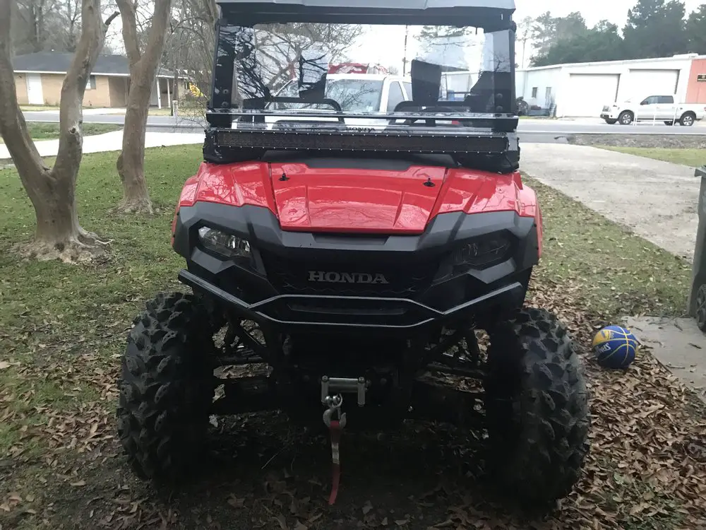

I get what your saying. My 44" autofeel was 45 bucks. I picked my price range and did my research and got the best output in my range.
Autofeel does their measurements in watts and kelvin. Mine is 6500k, 288w with 5D lens 150* flood 30* spot
Sounds affordable, I look them up. Have any glare as you have your mounted?
