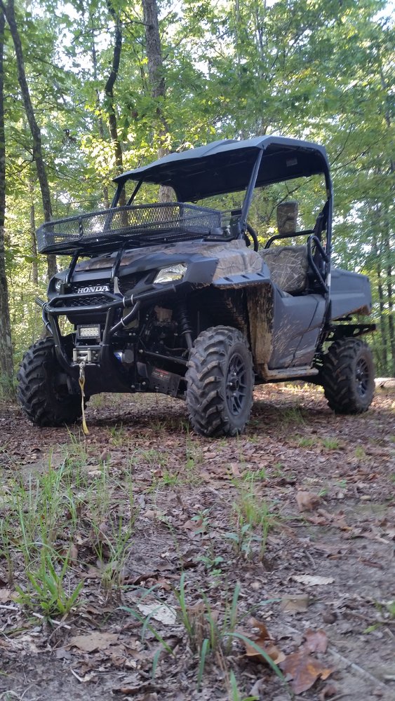

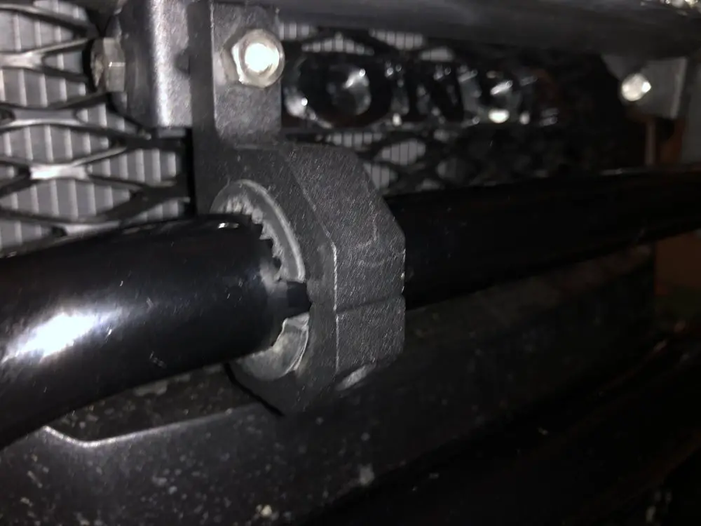

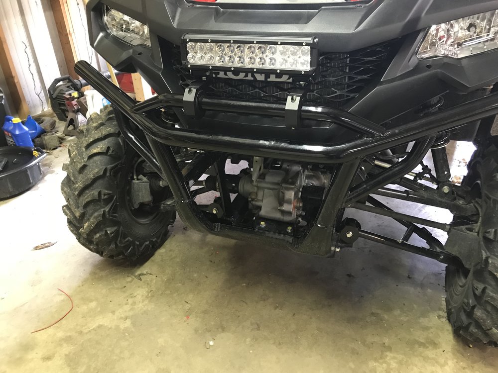

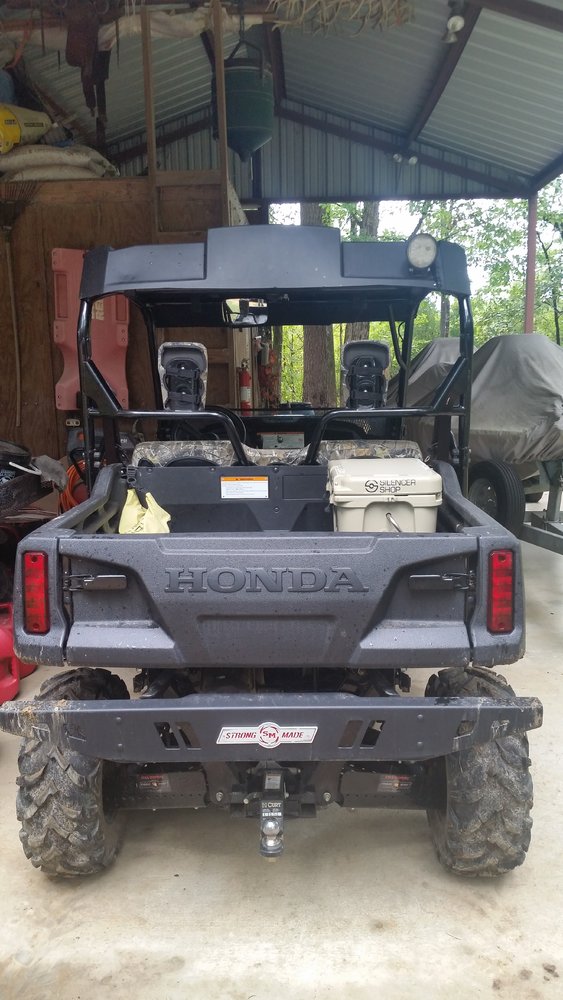

Here's the mount I made and my front light bar, and rear lights.
Img 20170417 145348 zps9rwkh385 jpg
Img 20170417 152002 zpsuul6kzqc jpg
I did a write up over here of my build: P700 - Light Bar and Mount

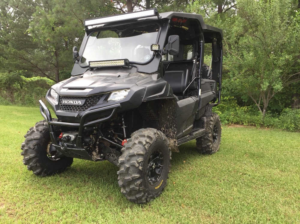

Does your light bar wiggle or move being mounted to the plastic ? I'm thinking about mounting mine there but want to make sure it will hold it firmly. Thanks for your time.
The lower one.
Very little I had to put a 3" long x 1" wide piece of 3/16" flatbar under the dash to steady it.

Thanks, I was thinking the same thing about putting something bigger behind the plastic just to spread the load.

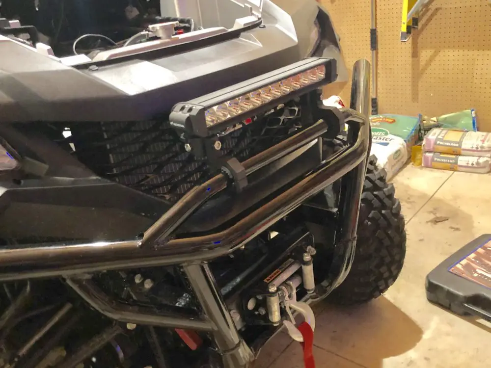

I used the Lamphus brand horizontal clamps they come with different size rubber inserts, 1.25- 2.0 I can measure it tonight after work and let you know the actual size of the bar.

The led light clamp kit I used was the lamphus cruizer horizontal bar clamps. Comes with 1” 1.5” 1.75” 2” rubber inserts off amazon. The front brush guard (bumper) is probably metric cause it measures 1 1/8” appx. (Can’t find my dial calipers to get exact measure) I used the 1.5” rubber inserts and added the supplied double sided tape behind the 1.5” inserts. Worked great very happy with these clamps so far. MFG # is CRLBXXA3-X2. Hope this helps.

Thank you.

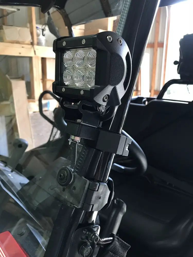

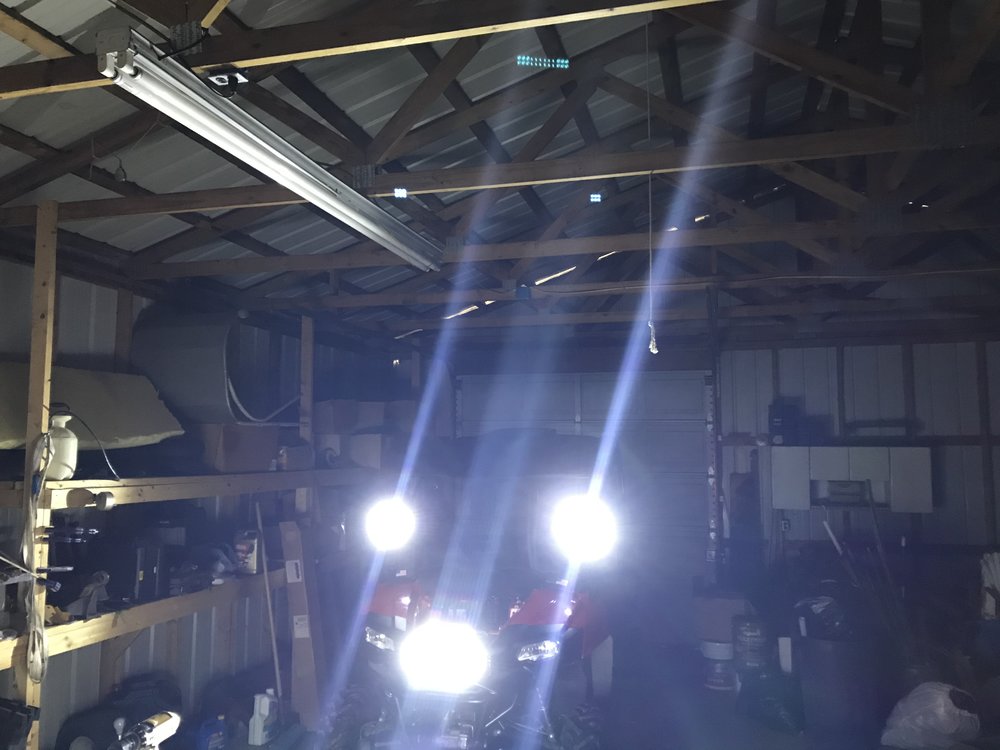

Welllll.... not a light bar, but I’ll be putting some Rigid Dually pods on the 700 when amazon delivers the ram mount clamps. The lights are from my duck boat, used to scout suitable places before daylight. I think this will be a worthy repurpose.

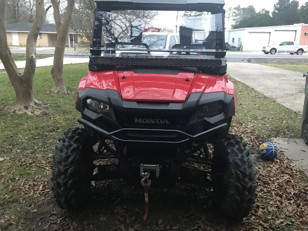

Did you make your own brackets for this bar or were you able to find some to mount the bar there?
I used the bracket that came with it. I’ll post a picture of how I have it mounted when I get in this evening.
