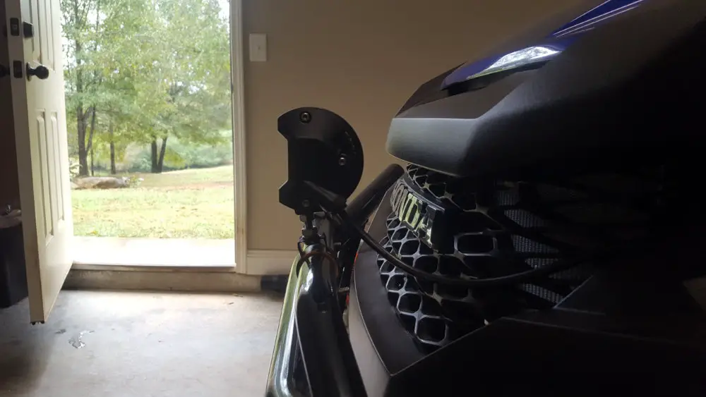

Bumper mounted 42" curved.

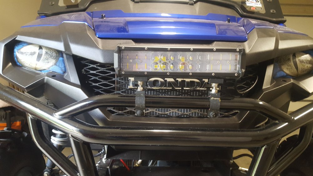

I noticed you used conduit clamps to secure your lightbar, that's how i did mine tooView attachment 166893
It works great I used stainless steel bolts so it would not rust with a strip of rubber under the clamps. I have never had a problem with it. It think it works good as or better than any mount. You have a good eye.
I used the exact setup with the ss bolt and rubber, electrical is my game, so I noticed it right off the bat
