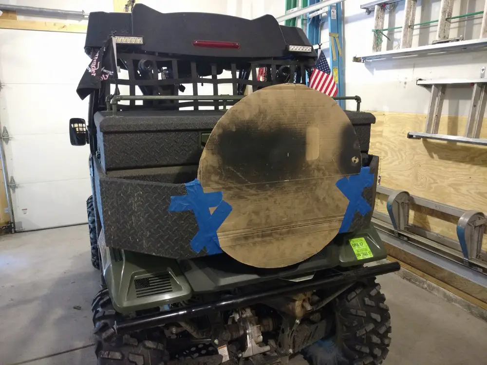

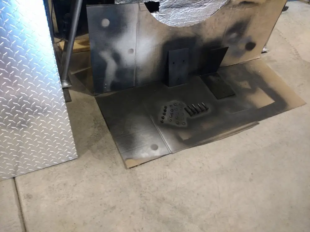

This is the plan...1/4" steel bent to fit inside the bed and another piece outside of it to sandwich the rail. Two bolts go down through the bed and through the rack, it's pretty stout. Made a mock up out of cardboard for fitment, doesn't stick up much more than the box rails and can still see the factory tail light. Hardware is under paint and waiting on the wheel and tire.
Btw, found one more spot to use up this chunk of diamond plate. Except for a locker and shocks maybe, this is it, the last wave. Will probably do more riding now but still need to find another hobby/project. :(

Put the steel in to carry the spare, now just waiting on the wheel for accurate bolt locations. Cranked the shocks up another notch in the back for the anticipated added weight, rears are maxed out now.
Started messing with that chunk of aluminum too.
Spare frame
Door
