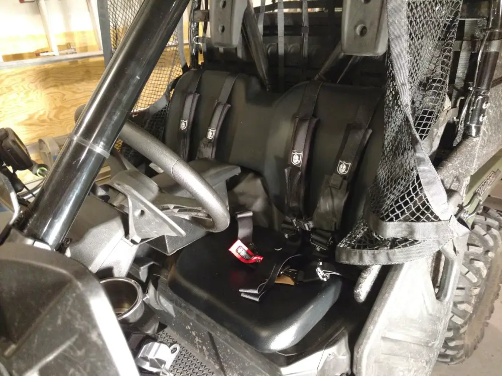

How do you like the harnesses Trigger and how was the install, any modes needed to be make to secure them?
Not much really, bought 2 bolts and had to cut a couple of little tabs off where the seat belt latches were. They do exactly what they're supposed to do which is hold you in. Not always comfortable being pinned to the seat though so just use the lap belt sometimes. A lot more sh** to go through when taking the seats and heat/sound barrier out though. Worth the sacrifice I guess.
