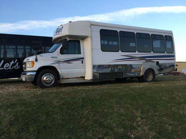

All way bigger than I'm thinking boys lol. Think Chevy 3500 chassis based 21 passenger bus.
This is on Dubuque Craigslist, in Lancaster Wis. 00101 hTuiGG3WJ0K 600x450 $6500 or best offer,175000 mi.diesel

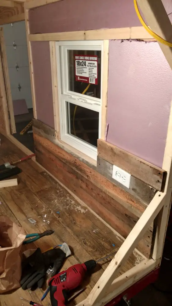

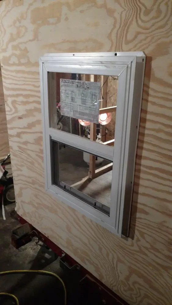

Little more chipping away at the camper today. Using pallets for the walls, the vote in my house so far is 2-1 that I either paint them or leave them raw for a log càbin kinda look. Window is in and sealed. I think it looks good enough. Gonna figure out some trim once I paint. 3 110 outlets wired, and need to do the 12v before I button up the ceiling.

Cool, that looks like a house window!!!! Pallets, dude you are frugal. Looks like that would be heavy???

It's a utility window from Menards, so yeah it is a house window basically. The pallets are a bit heavy yeah, but truthfully I think I need a little more weight. It still has less than 50lb tongue weight. And yeah, I'm cheap. Lol

Haha, that's not the first example I've seen of you're being cheap, but it's the best, lots of laughs. Easy as it would be sense your trailer frame is a bolt together, I would slide your axle back 6"-12". If you take note of most trailers, and particularly those designed with "light weight" as their primary goal, they all have a much rear of center axle to provide the necessary tongue weight right off the bat.
