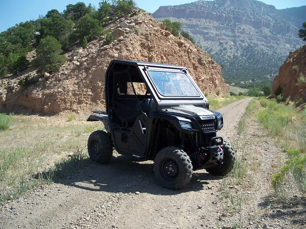

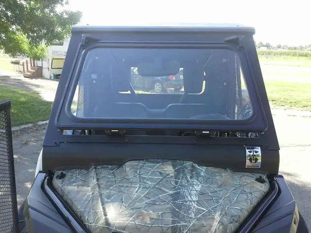

They gotta be Ridged to
take the abuse...bumps
slams....so ....this one's
Would be my choice

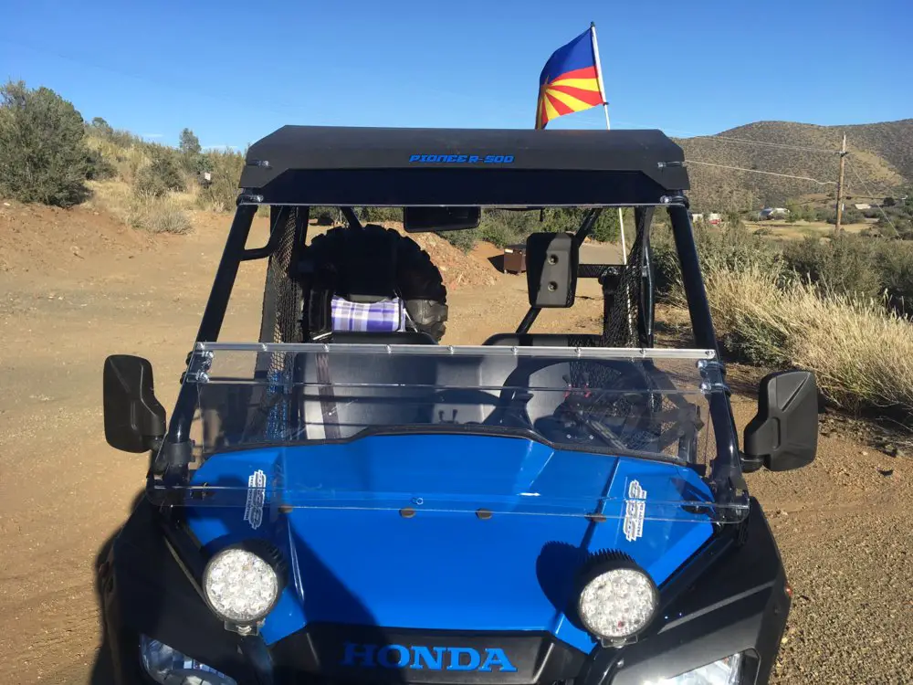

P5 limo
3pc lexan top section limo tinted '//
P5 limo
HUCK
HUCK
Jun 21, 2016
1,047
2,319
ARIZONA
That's the best cheap route I've seen! Wish they made the fold lower.. I like it though!
It looked high in the pics But as you can see it is a little lower than the top of the steering wheel . I was happy when I put it on and saw that it seemed much higher than it really is .
Reactions: JTW
That's offficially my back up plan..
Jshell3
I bought the $125 Lexan 1/2 windshield (15.5"). Has a seal / threshold on the bottom. It's not scratch proof, but it's dang near bulletproof!
My wife and son were baffled at the idea of a half windshield, but I thought it's ingenious...
Just got it installed today and we got to take it for a test spin...
We all like it now!
