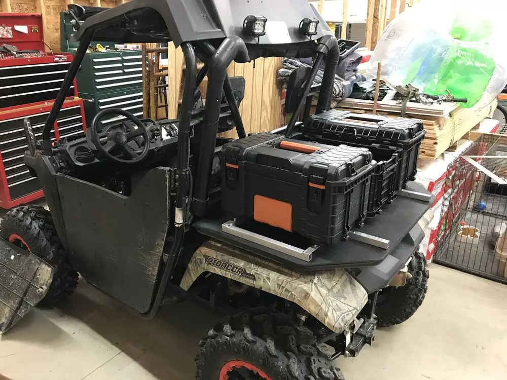

Used mine last weekend. Broke in the toolbox and rack combo.

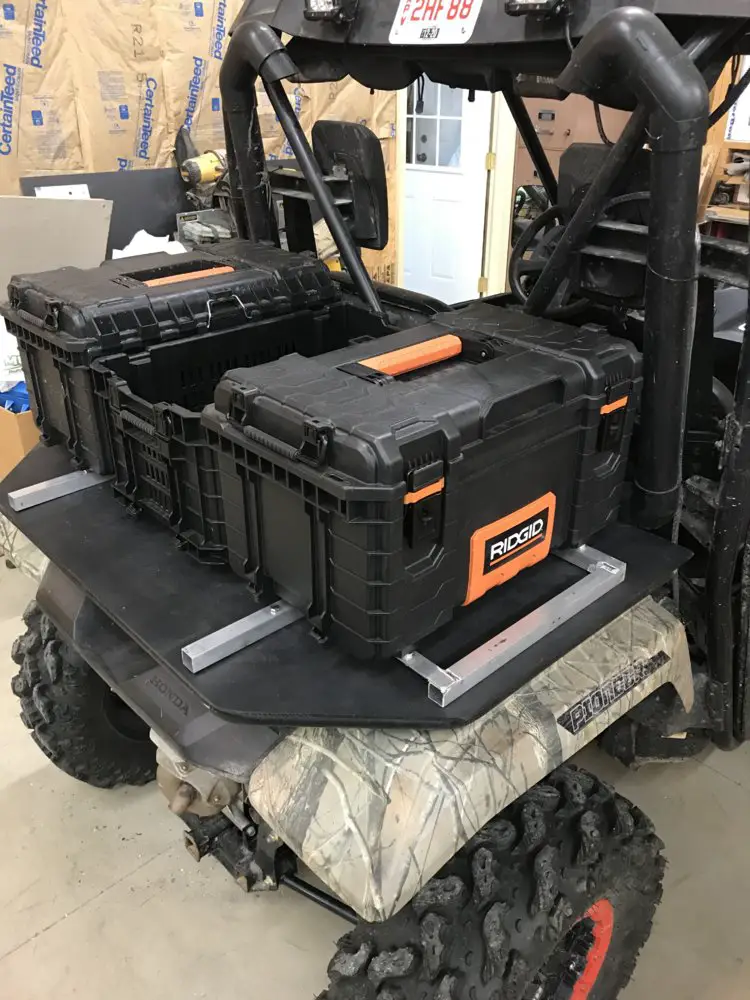

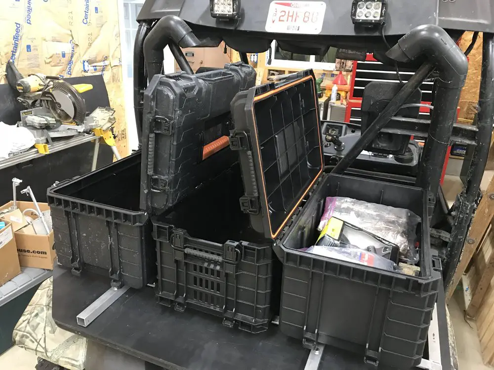

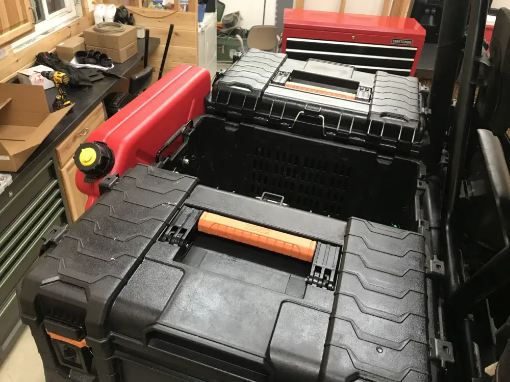

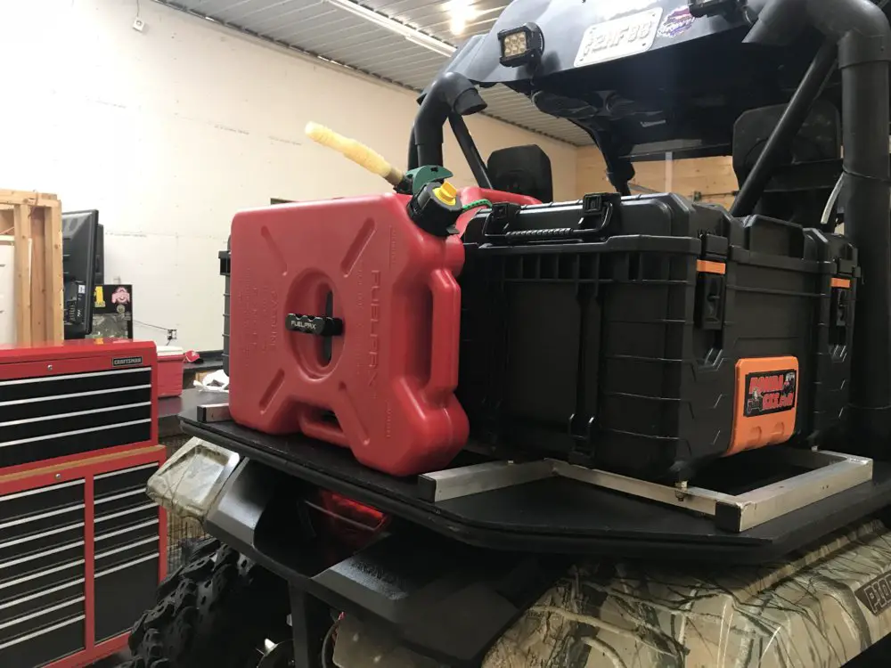

I've got that idea patented. You owe me one Talon 1000 for patent infringement! LOL. Glad you liked the idea enough to use.
I've been very happy with it. Keeps most items clean and dry with some flex space in the middle. I planned on cutting a slit in the middle box for the bar of a chainsaw so that it would fit in there nicely. I also found a soft side cooler that fits inside one of the boxes if I need to keep my beverages out of site. Probably the worst part is cleaning it and water sitting where the handles of the boxes are.
View attachment 95124 View attachment 95125 View attachment 95126
View attachment 95124 View attachment 95125 View attachment 95126 View attachment 95127
I saw the original post and I plan on building the same. Just let me know where to drop off the T1000! Seriously, how did you attach things? I assume you drilled holes in the bottom of the boxes to attach them to the aluminum frame. Do your 4 bolts hold the sheet plastic plate to the rack as well or do you have the plate attached separately? The flat gas cans are a new addition as well, How much do they hold and where and where did you buy them? Thanks for your help! SonnyL

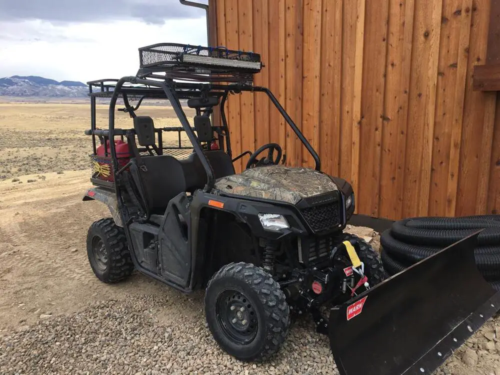

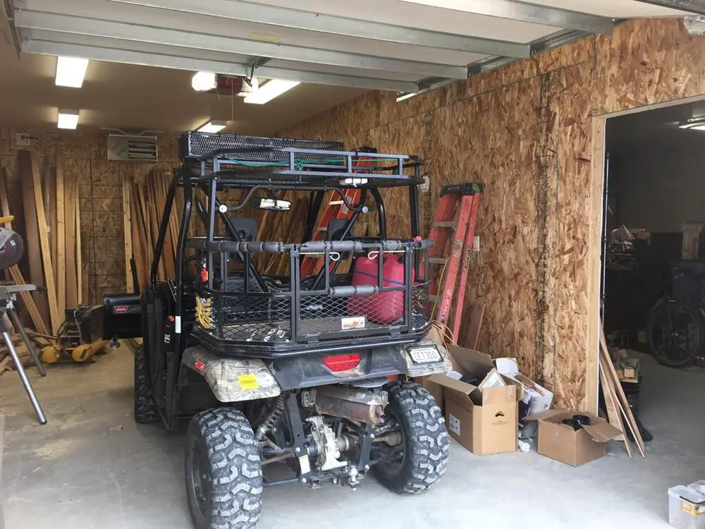

Yes. I don’t ride aggressively. I think the upper basket is going somewhere else when I get a windshield.

I have 4 bolts holding frame on rack and the 4 bolts on each container holding it to rack. I believe I used some small holes that were already in the rack, may have enlarged. The HDPE piece is just sandwiched between the rack and my aluminum. I purchased some 1" square aluminum and some 1" angle aluminum. Square runs front to rear and holds it all on the rack. The angle goes side to side and boxes mount to it. Once I notched the angle to fit over the square and set it all up and had the aluminum welded. I will try to get some more pics since I currently have one of the boxes off. Should give you a better idea of what I did.
I believe this is the fuel can and mount I used. I don't think I paid this much for it though.
